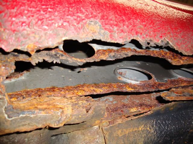

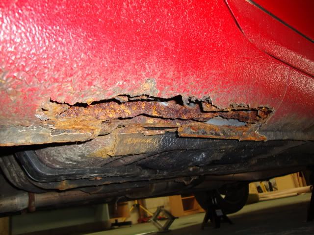

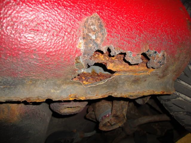

I went to the warehouse today to start on what was supposed to be a complete brake overhaul and some paint prep. It turns out that I have a bit of a larger problem with rust than I first thought..............
Drivers side
Passenger side
What do you think then, repairable? Or should I just break it and sell for parts?

Looked quite bad to me as the hole on the drivers side is about a foot long and there is no sill left at all to weld anything to. I'd be needing inner, outer and arch panels for both sides so is it an economical repair? I can't weld so I'd have to pay to have done but the paint I'm not so worried about as I've got someone thatw ould be able to help me out with that.

Thats quite bad IMO mate, whilst you can pick up outer skin repair panels now quite cheap money, there are actually 3 of them each side, the most inner one only available from nissan at around 200 big ones.
However a decent metalworker and welder could overcome that part perhaps.
Suggest lifting the rear bench seat and then the carpet to see how far in towards the middle of rear floor pan the rust has gone.
Let us know what you find.
I replaced all 3 panels on drivers side and 2 on pass side, doing it properly was quite a big job!

Pricing individial corrossion repairs by photo`s is difficult, the most inoffensive level of corrosion can turn into a huge job once started, equally a big looking job can end up been an easy repair, inspection and an open mind once the job is started is required.
Having said that typical pre paint repair cost for two rear sills inside and out and of course subject to actual inspection £300+ vat to £400+ vat. the price artztogo got was does seem very good.

Had to do the same last year. But it does get worse unfortunately. You'll find bubbles on the rear wheel arch that are worse than they look then take the rear bumper off and find frilly lower arches and lower rear wings that are hidden that also need done - at least they dont need to be pretty since the bumper hides them. Then when you think you are almost there you will find bits at the front end of the sills and floor pan at the front of the footwell that also need looking at. There are lots of double skins and in the rear sills four separate layers to restore including the outer skin.
Oh and when you remove the rear bumper you find that the 3 metal stiffener bracket pieces that support the plastic bumper have also pretty much reverted to iron ore. You have to make those up yourself to get the bumper back on again so again what looks like a simple job to remove and refit the bumper also gets bigger.
