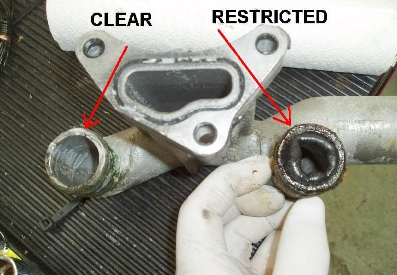

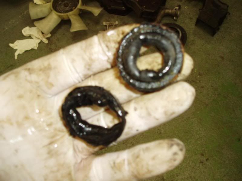

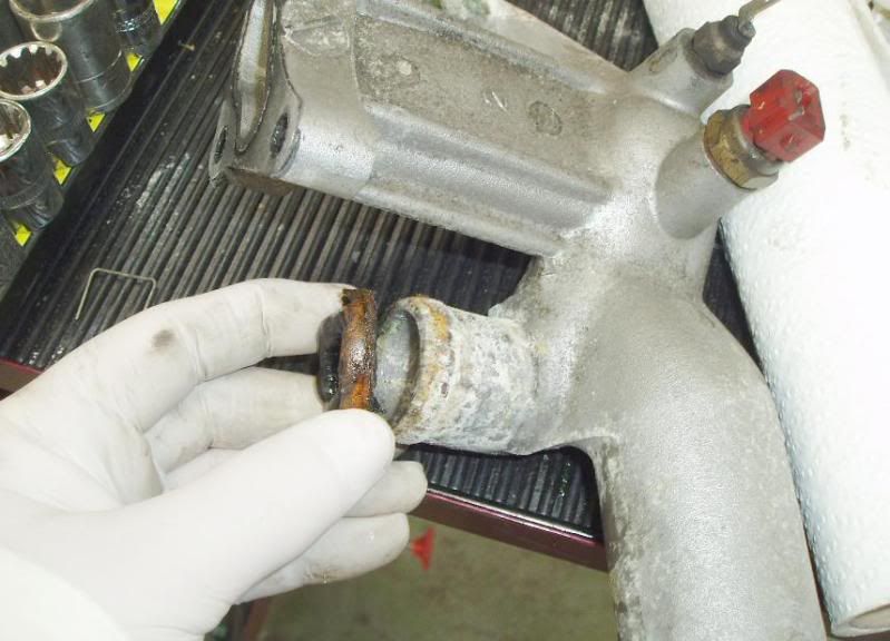

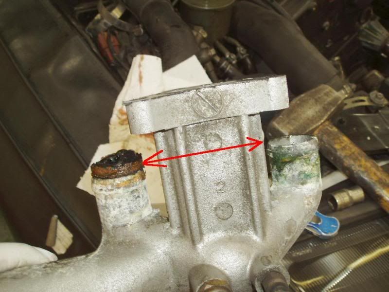

These two photo's shows the upper water pipe removed, it appears to have an extra it was not meant to have, excess sealant had squeezed out and formed a large ring on the pipe end.
This photo shows how extreme the problem caused by excess sealant can cause, the pipe inlet has been reduced in size and flow by at least 50%. what was even odder at this point was the extra sealant was only evident on one side.
Removing the thermostat revealed more sealant and when removed completely we had found the missing sealant from the water pipe that had migrated down to the thermostat.
