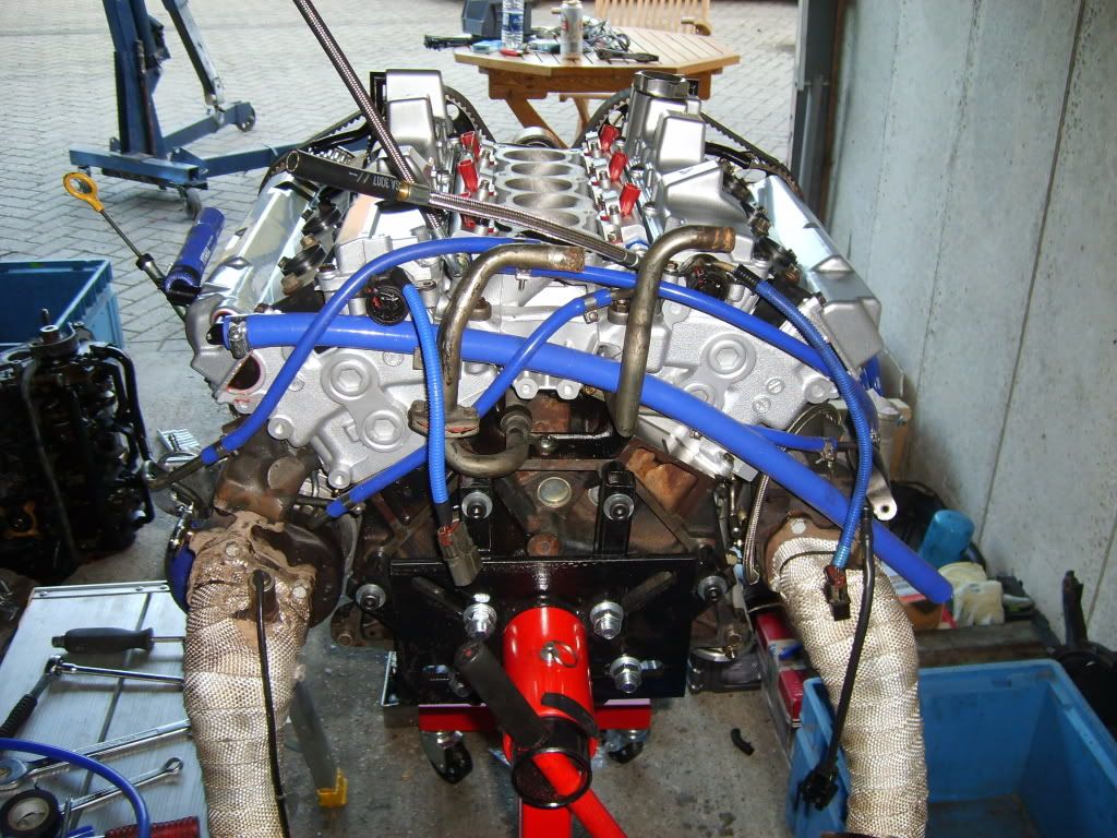

What else to remove from behind engine
Why did i start this:sweatdrop:...is there any little hoses or conn lurking behind engine by firewall that people like me [engine removal virgin] miss when pulling engine out......i am nearly there i think:wacko:

the only things that you "need" that sit behind the engine are matrix water hoses, turbo water feeds, det sensor (if keeping, of course) and VVT wires. every thing else can be junked, which is only the EGR valve and connecting hoses, so the rear should look a bit like this...
bearing in mind, ive done a throttle body bypass, which i would recomend if you're pulling your engine

Cool looks like i have removed it all, what about the oil lines from cooler were do i need to remove them from?
Also i cannot get on to the jubilee clip holding lwr turbo hose hard pipe in place below throttle body on o/s!! can i leave this in situ?

the oil lines can either be removed directly from the sump and oil tree or from the hard pipes on the left inner bay liner, i presume you mean the engine oil cooler and not a gearbox cooler.
the only IC intake pipes that need removing completely are the four "hard pipes", the two large diameter plastic pipes (one each side lower down) just need disconecting from the sides of the radiator, they are a pain in the arse but do bend quite nicely to allow them to pop out.

Going back to the oil lines from cooler [engine] been looking at them is it easier to discoinect on the chassis leg near the front of the car? and if so would the hoses come up threw with engine.

there should be solid hard lines running along the side of the engine bay just by where the alternator is, going to the front where the cooler sits, the rubber pipes coming from the engine will be fixed to those hard lines via jubblee clips or those stupid screw versions. you can disconnect from those and let the rubber hoses dangle.
the easyest way to get at the top bolts on the gearbox is with a 1 1/2 to 2 foot extention with a UJ and 14mm socket on the end.

And get to them from under car? [how many fixing bolts all together?]
Thats ex where i have just disconnected the pipes from:cool3:
Edited by yewcheck
yep, get to them from under the car so the ratchet is at the prop shaft end of the box,
there are 10 bolts in total, seven bolts are going through bell housing to block, and three go the other way, from block to bell housing
