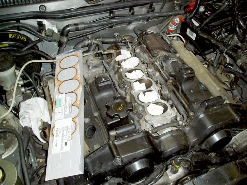

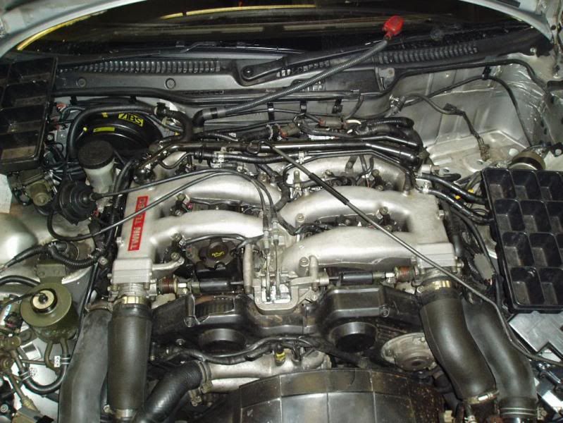

Follow the pics as the strip out started today, the plenum removal starts first.

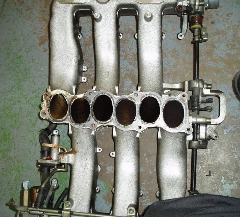

The plenum was soon off and the gasket was revealed, the condition as can be seen is very second hand

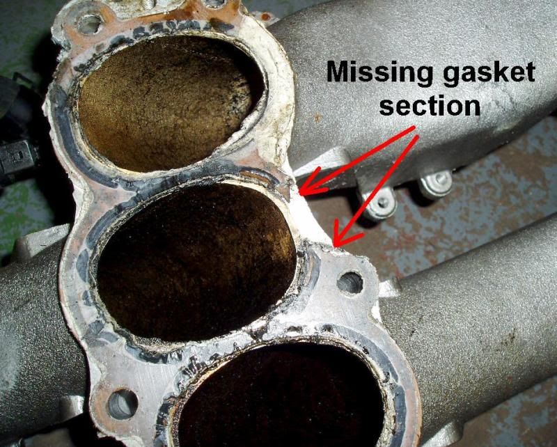

Closure inspection reveals a large section of the gasket missing, that's the dangers of reusing old gaskets.

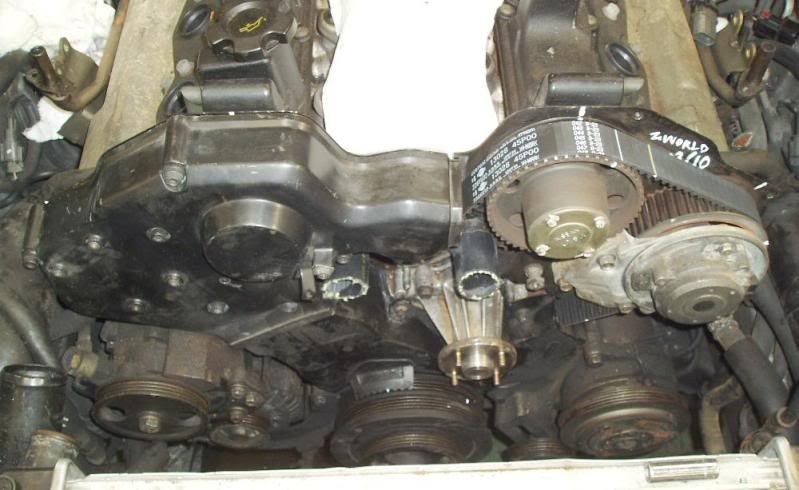

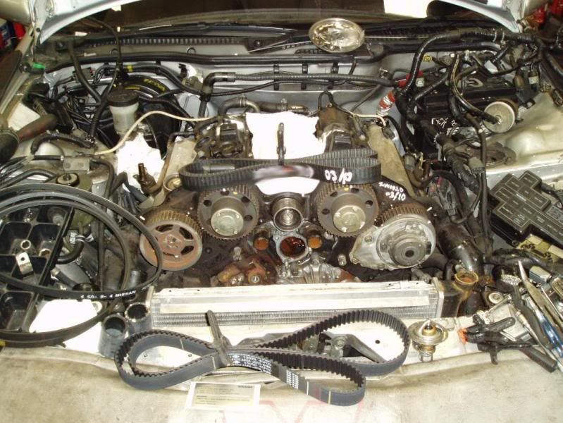

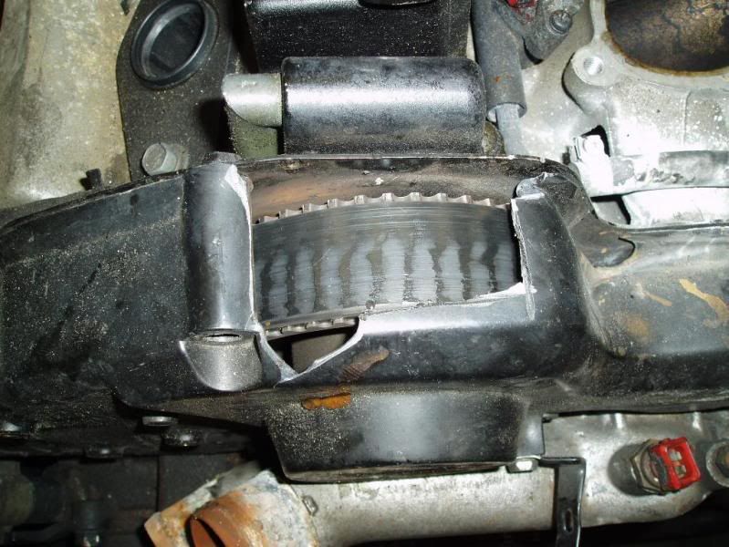

As mentioned the cambelt was revealed by a break in the cambelt cover, in fact that area of the cover had been catching the belt.

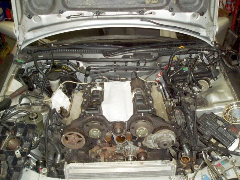

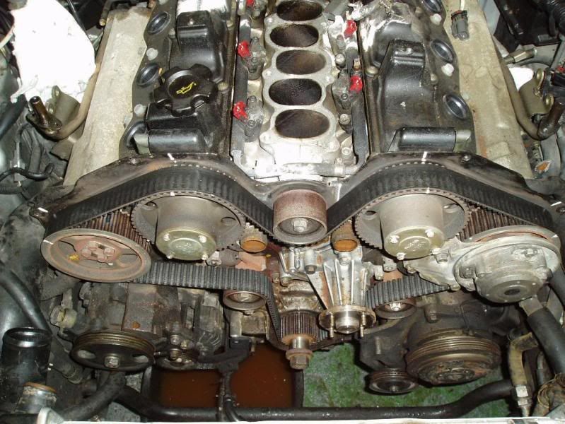

So the belt was stripped out so that can be changed, the red injectors are very visible now in the back ground

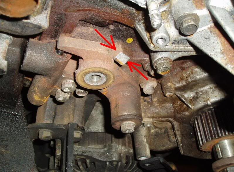

A broken cambelt tensioner body was discovered, the break bizarrely looked clean??

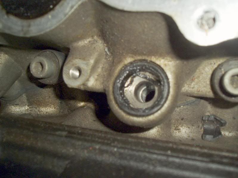

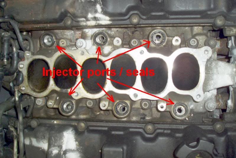

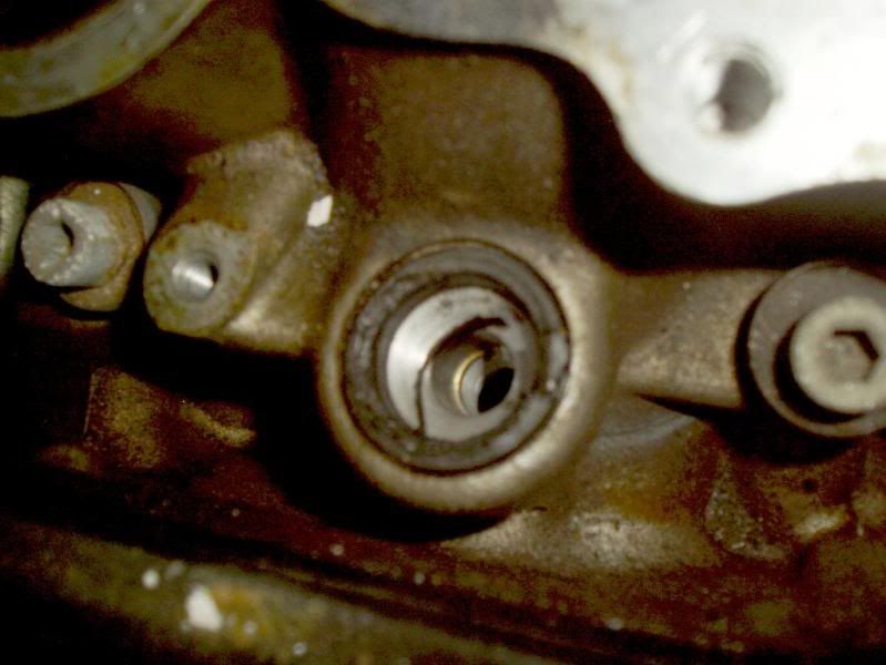

So back to the injectors and so the complete rail was removed with the 6 injectors in one piece, the injector port seals looked to of been reused one's and clearly not very well, all six showed signs of damage, how they were sealing is a mystery.
All stripped

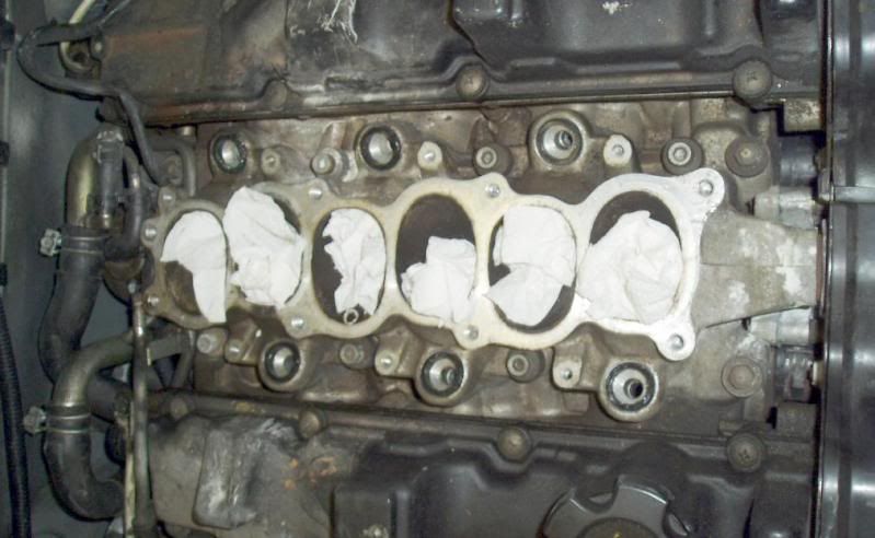

So back to the injector problems, stripped out yesterday and the ports all cleaned and new seals fitted and greased ready for the injectors.
So a tested replacement rail and injectors fitted with new fuel link pipe, and the white stuff everywhere is talc, used previously by the owner to trace a fuel leak.
So matting faced all cleaned and gasket at the ready, plenum back on in the morning, connect up the loom and fuel pipes and should be mainly complete by lunchtime, back with final completion pics then.
