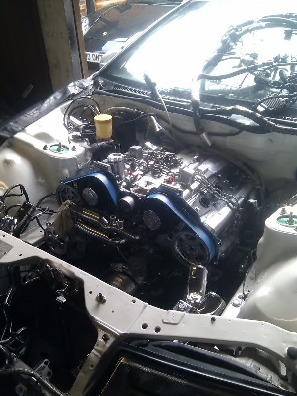

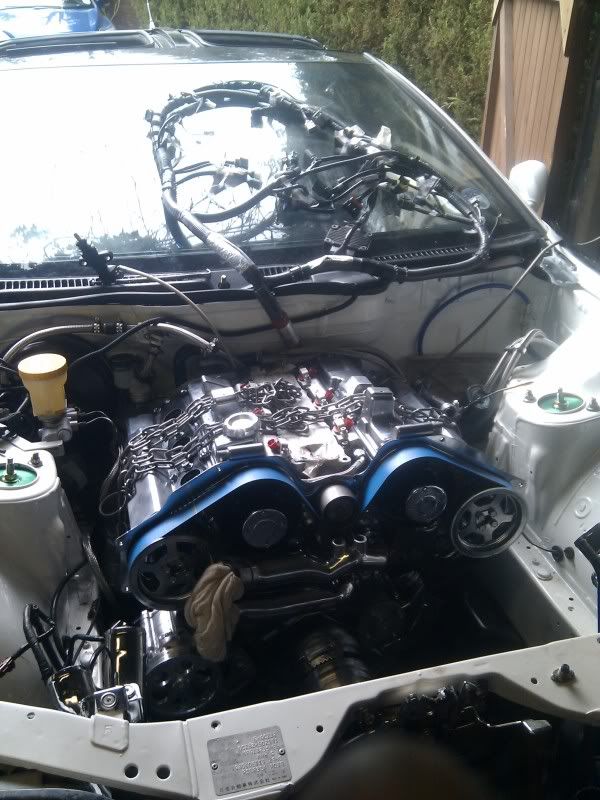

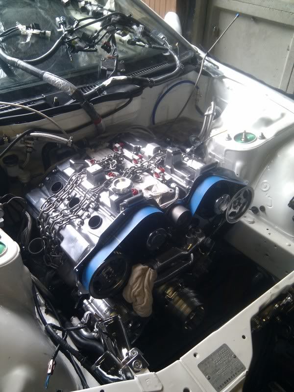

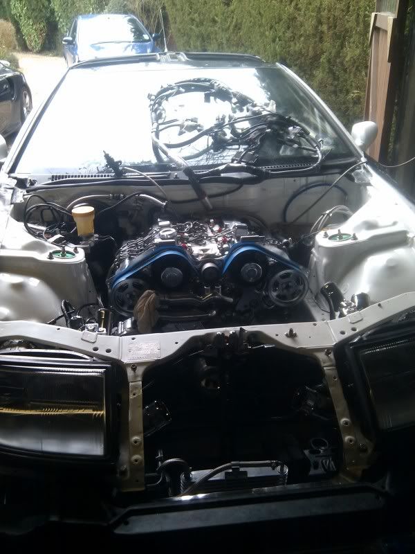

My Engine test fit
Jimmer and FunkySi came down yesterday, a big thanks for all the help!!.
The timing belt is now on and Jimmer also put my new cams in, really posh new intake sprockets and new turbo oil feeds. :w00t:
There are still a few little bits to do on the Engine before it gets its final fit. But it had to go in the hole so I can get someone out to make me some new power steering and NOS pipes up.

That looks superb! How are you mounting the nitrous system? Into the intakes either side or directly ported into the plenum?
very cool indeed :thumbup:
nice porker too :thumbup:
The nos needs to be 6 inches in front of the throttle body. I have had to drill and tap a hole into my new 300 degree rails for the fuel feed. All the solenoids will be where the old AC rad used to be and the injectors will go into the bottom or sides of the hard pipes as not to ruin the look.
