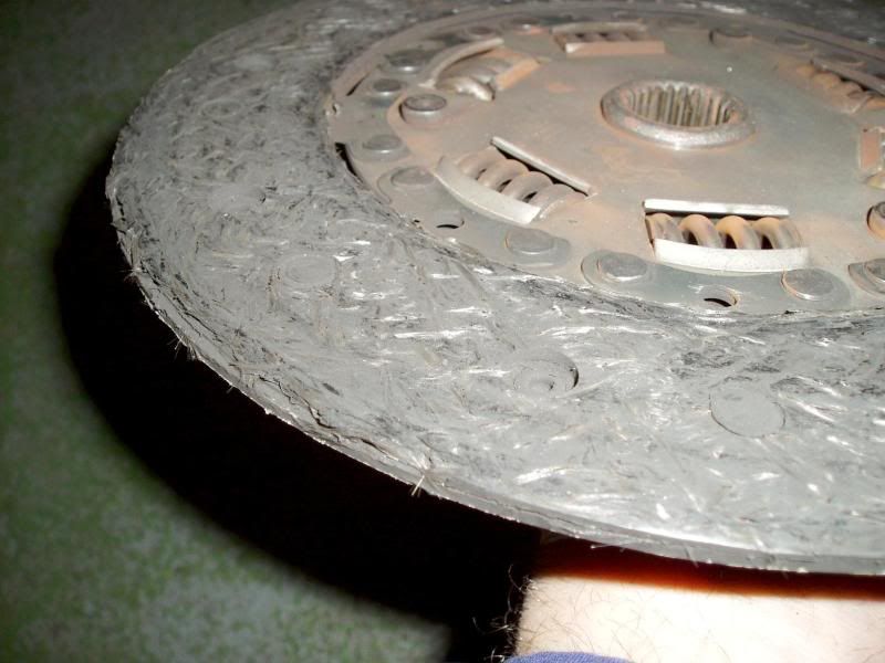

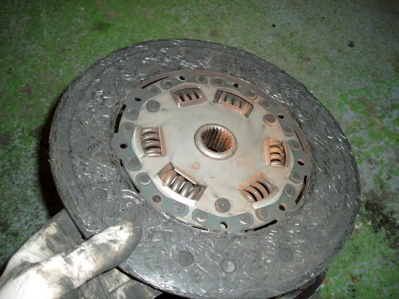

When considering an upgrade clutch the last thing many owners would be thinking about is any early demise of the unit. Check out the pics below of a very poorly RPS clutch plate recently removed from a twin turbo, there had been clutch judder and poor clearance from day one of the install, but eventually a failing gearbox ( noisy in neutral ) forced a gearbox change and hence the clutch been revealed.

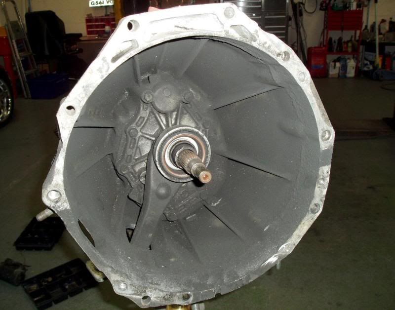

The bell housing was full of clutch material so early in the strip down it was clear something was amiss, the clutch pedal bite was very high and it was no surprise to see this, however the cause was.
Once the gearbox was removed the input shaft float was excessive as was the noise when rotating it, the release bearing was quiet as a church mouse so the gearbox input bearing / idler shaft was defo a gonna.

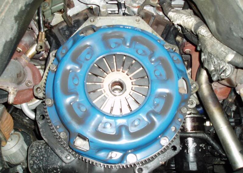

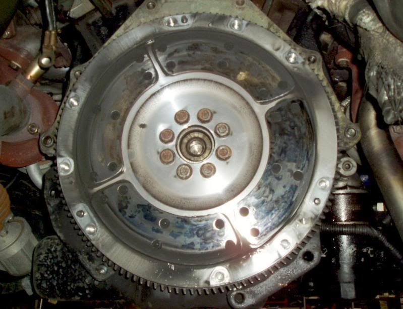

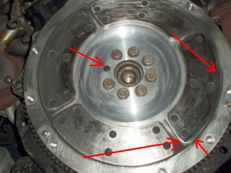

The segmented flywheel looked marked but it was only on closer inspection the cause of the unit failure was revealed. One of the segments was very distorted and in fact was holding the plate at a very odd and not flat angle to the rest of the segments. This is the cause of the damage to the edge of the plate, also the judder and the poor bite, and of course all of this could have been what killed the gearbox bearing?
So how and why?.....simply no idea, the unit is a well proven one and was installed by a well know and respected guy and I have no reason to think it was damaged during installation but the damage was unlikely to of occurred in use, so it can only be it was damaged in transit and maybe (speculation) it was not noticed and maybe combined with a dark workshop ?? don`t know.
