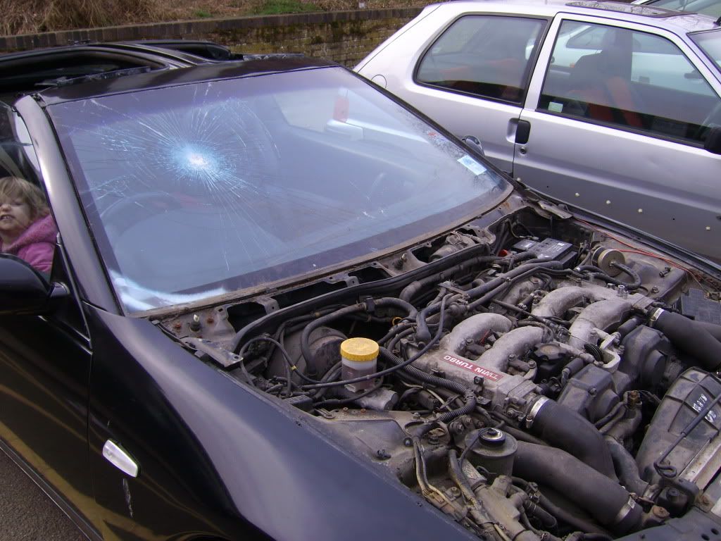

Right as I'm now using a PC instead of a phone. i can say whats really wrong with it.
Windscreen smashed, but getting that fixed tomorrow.

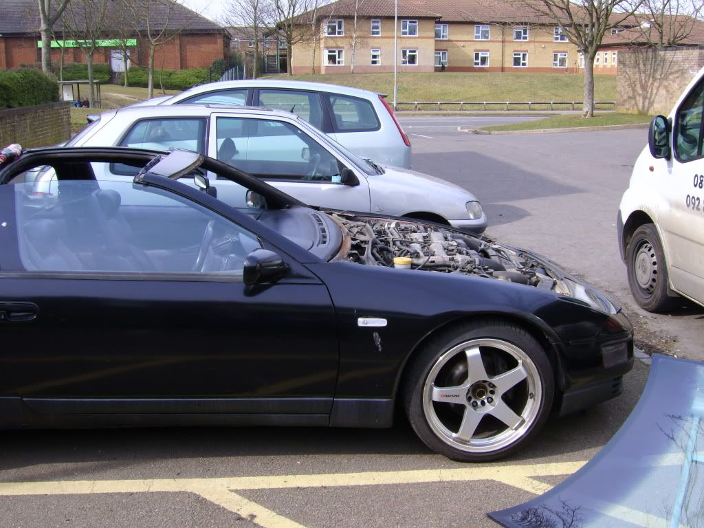

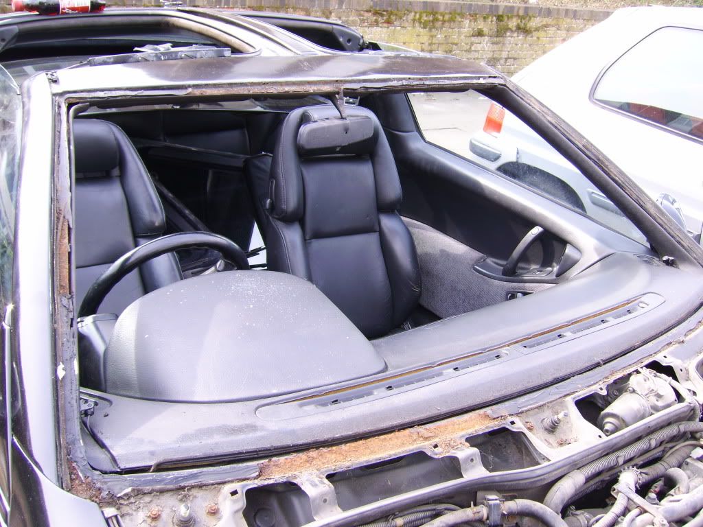

Here are the photos of today's progress, windscreen renewal
To help the guy out, bonnet removed, cowling removed an weather strips taken off, already for him to arrive and start work, making it much faster for him, not only that, means hes not damaging any of my fixtures.

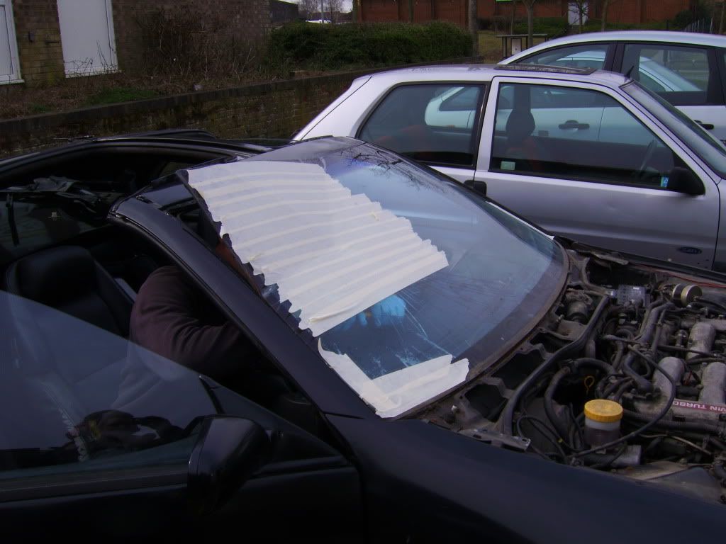

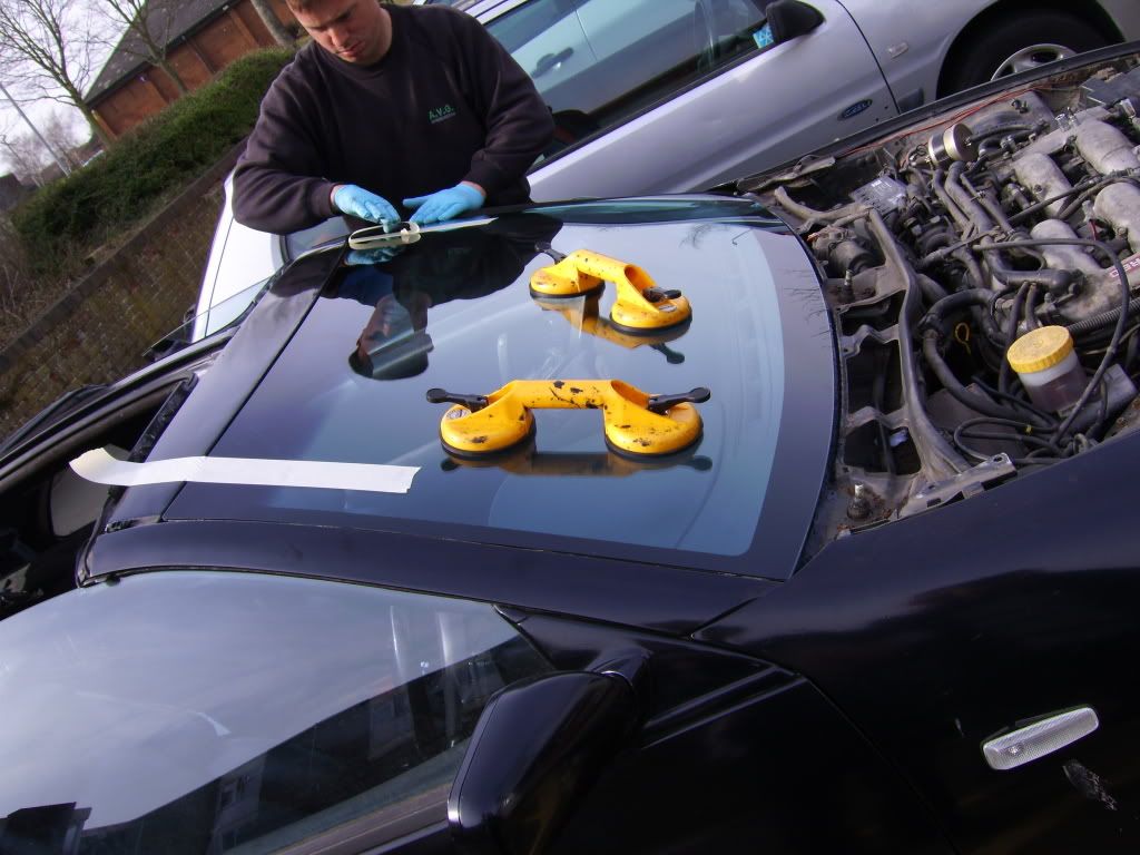

Bloke arrived and quickly tapped up the window and started to remove it.

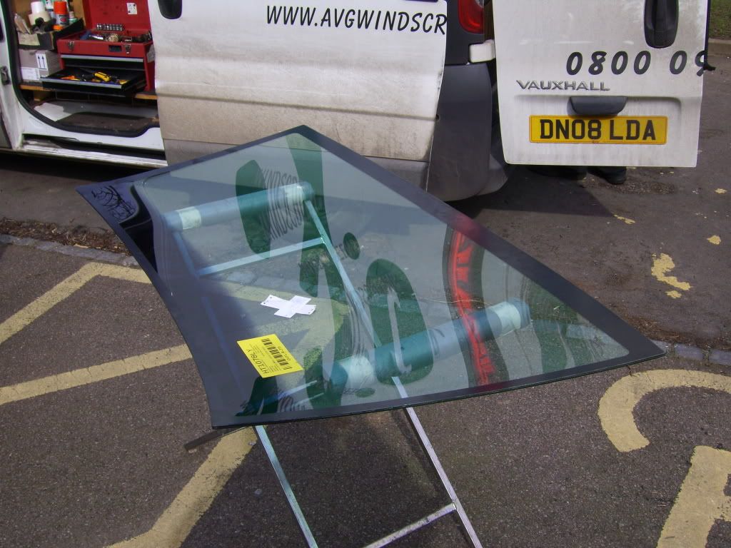

ooh pretty, windscreen removed. bonnet in the boot lol, yes it fits and safest place for it tbh
yay my new screen

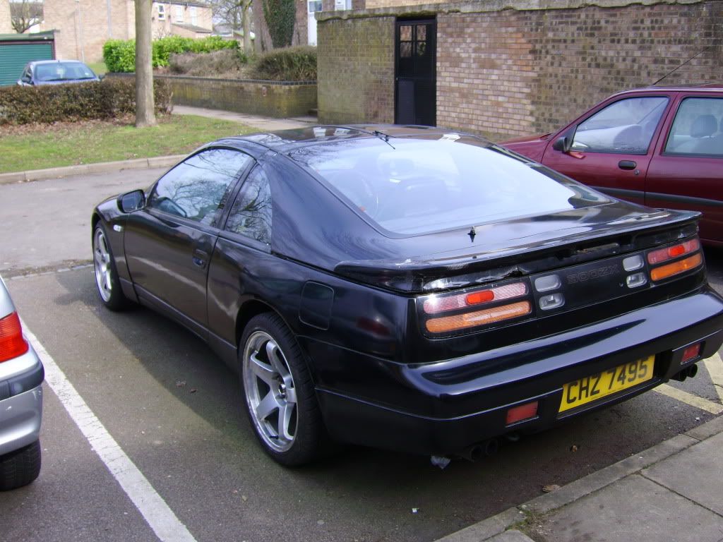

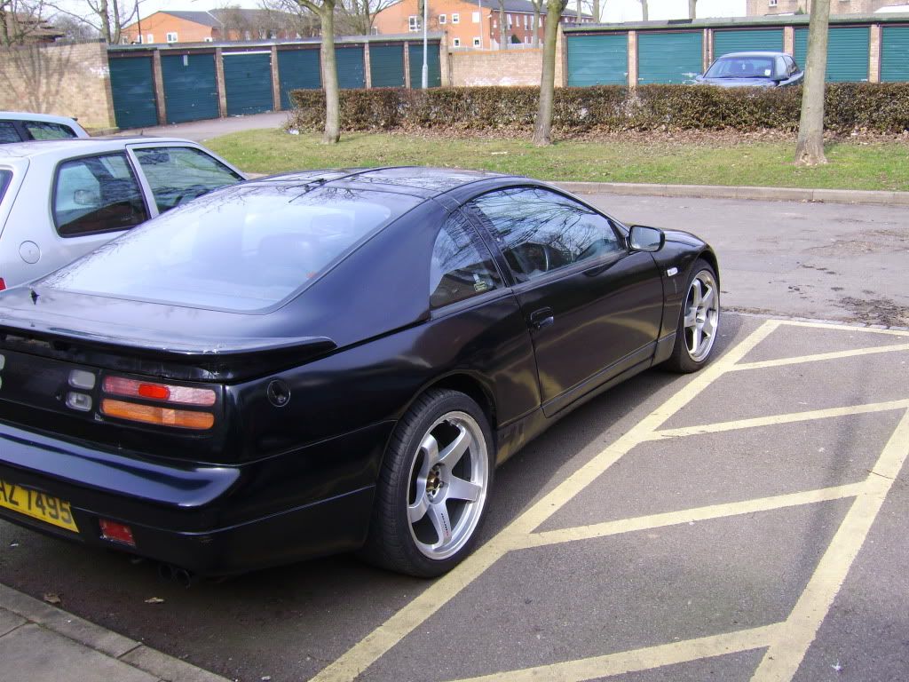

go faster stripes didn't quite work out as planned.
More shots just for the fun of it, why is the Zed so photogenic?
Ass end
Paint job looks ok here too, just noticed im missing the rear spoiler brake light. something else to add to my must get list. always have loved the OEM older spoiler. makes the back end of the car look so much sexier
nothing better than a new widow screen. wheels look great :thumbup:

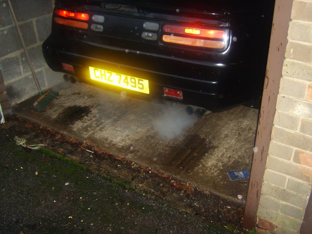

Right, this is what my car is now doing, please note the water under the tail pipes (not the trainers lol)
and here is the nice puddle i get under the passenger side turbo, and it is losing coolent, as i had to top the rad up again today,
Water from the tail pipes. it gurgles at the tail pipes, not from the wings.
