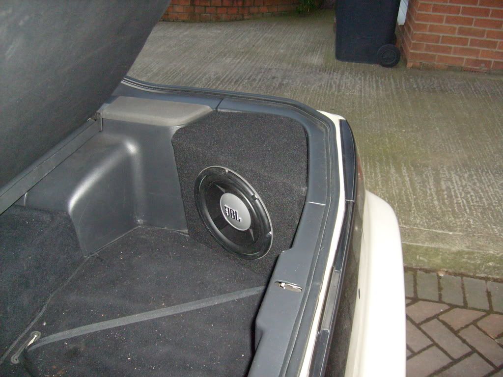

Thats great Dann, same JBL sub I`m wanting to fit aswell, nice and neat in the corner
the boot is a very similar size too
cheers Daz.
cheers Daz.
obviously it wont matter too much to you having a vert but i did it like that and built an identical box with a removable lid for the other side to house the amp and have storage space for things. it just leaves enough space down the middle to fit the targas in there during summer.
if i were to do it again i would either buy a less powerful amp/sub combination as the volume of the box isnt quite big enough and the amp has to be turned down otherwise the protection feature cuts in to stop it popping the speaker, still miles loud enough tho. or i would just build 1 box big enough for the speaker and somewhere for the amp to mount hidden out of the way with a large enough volume to cope with the power of the sub/amp.
