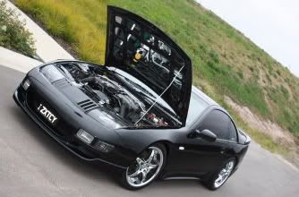

just an update to the lead post in this thread, i have fit the hid's and they are superb. :yes:
very simple fit on my j-spec, no fiddling and adapting needed, can take as little as 10 mins but take your time and tidying ballasts up, etc, give yourself a good 30mins. :drool:
used the original rubber gromet as well as the one in the kit, just needs to be fed through one multi plug wire at a time, care needs to be taken when offering the bulb through into the headlight and seating correctly and then getting the clip over, but all very easy. :clap:
i have included lots of pics, all the links for the bulbs i have are in this thread and are now all fitted.
i had the car tested on the 9th and it went straight through :thumbup: with no advisories, no mention of the xenons at all or the alignment, so i must have it all spot on.
i recommend with confidence this kit. :tongue:
not sure what to do with the ballasts, should i hide them in the front as they will just reach or keep them on show? certainly don't want them just loose as the passenger side is currently. if i could say anything against this kit is that the ballasts are chunky, i have not looked but if you can get slimline 55w ballast then they would be better. :dance:
keep your halogen bulbs in the boot as these can be put back in seconds, no problem should the hid's fail for some reason.
