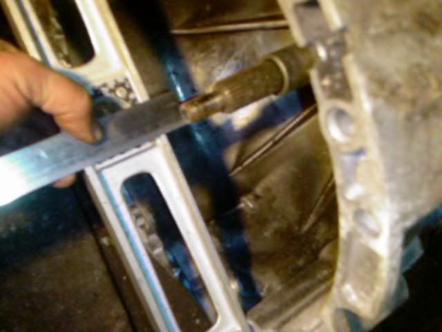

I have been told the splines are the same for the s15 and z32boxes,so the clutch plate should fit,I was going to fit a cover from the z and plate from an s15..but as you said,the s15 has a dualmass flywheel,and is twice as thick as the standard z flywheel,therefore I dunno yet if the spigot shaft is long enough or too long.I will take some measurements and post them up 2moro,hopefully someone here can give the measurements if they have a manual box laying about,as I only have a dud autobox here for comparison.

Can anyone who has a few mins to spare and has a z32 manual box off the engine,take measurements as shown in these pics,also if possible can someone send a piture of the manual gearbox/bellhousing,so I an compare with the autobox I have here.Thanks.

Its the diameter of the spigot shaft I need,the end that goes into the crank, and the length of this from tip to the splines.
Also,using a straight edge,across the bellhousing,the distance between the face of the bellhousing to the tip of the spigot shaft.Hope that makes sense?:)

when i measured my pilot bush the id of the bush was 16mm diameter if that helps.
first pic is tt bellhousing and second pic is non turbo bellhousing

measurement 1: -12mm (in other words it sticks out of the bellhouse)
measurement 2: 16mm
measurement 2: 16mm
:thumbup1: Thx mate!
