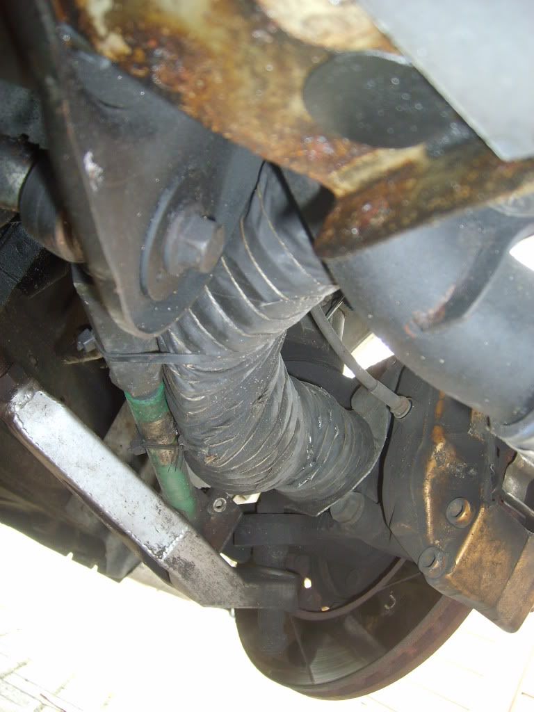

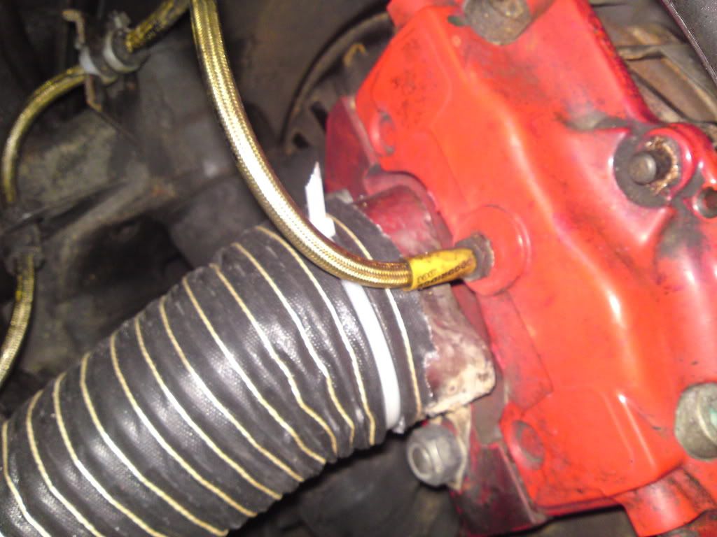

i used 3" flexi hose but, 2 or 2.5" will do it.
as for fitting the hose to the duct, it's only pushed on so the bumper can come off cleanly.

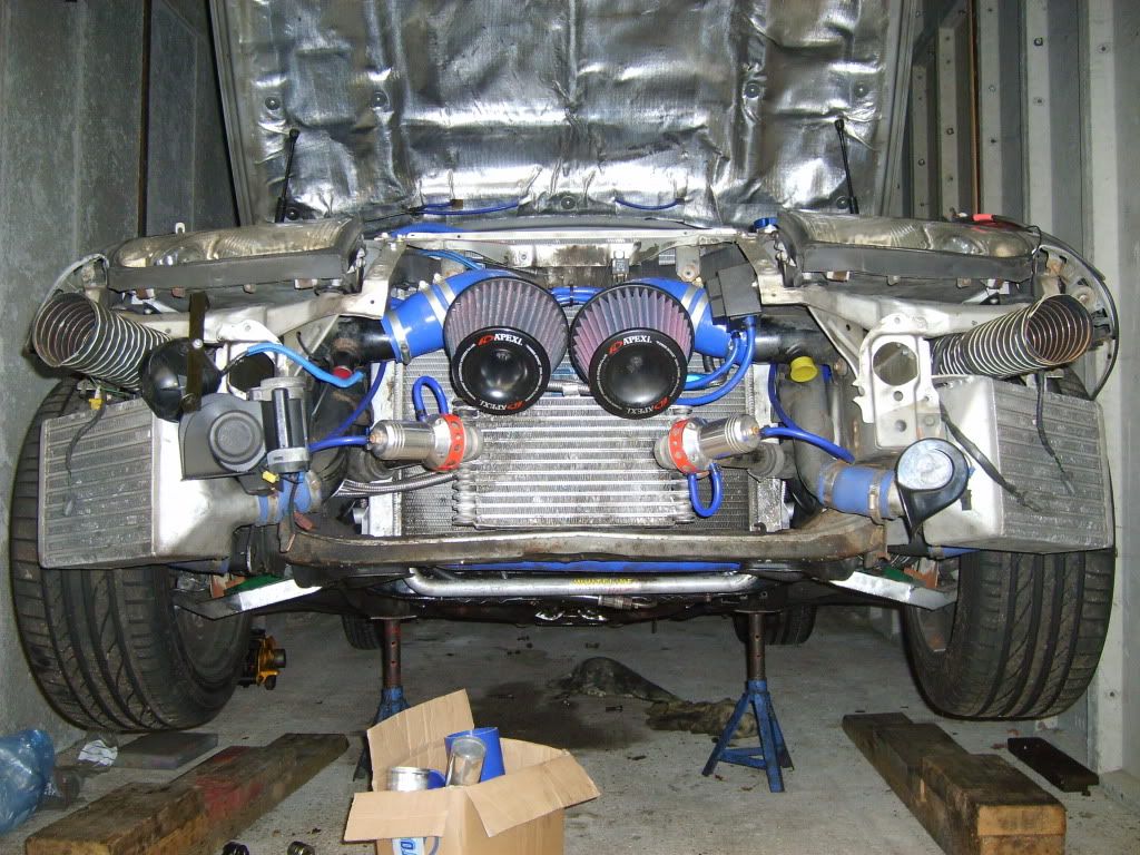

i'd hold fire until jimmy gives you an idea of how much you'll need. i seem to recall that he needed just over 1 meter each side, i'm sure that the 2 meters he bought wasn't enough. it might be worth messaging the seller to enquire whether he can cut some to lengths of 2 x 1.5 meter ducts. he sells 500mm lengths so he could still sell the off-cuts, this will save on the hefty 60 quid price tag of 4 meters!
then again jimmys intercoolers are mahoosive so it has a big divert to take and his intakes for the brake duct are't in the foglamp ducts so you may be ok.
i bought 4metres in the end, was a bit of a journy round the intercoolers etc
yep, it all depends on what you have to trail it round, i would say 3 metres each side, that way you will have enough to play with and then some to do the rears with as well :)
yeah i got all my old 2.5 inch i could prob do the rears or make some ducting to the turbo housing or somthing, i have not decided yet.
