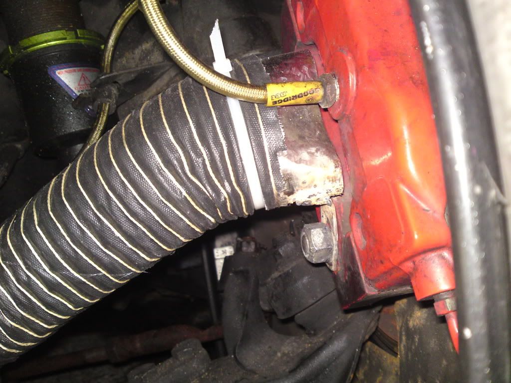

heres where the ducting is directed, right into the centre cavity just behind the caliper, luckily there is enough room behind my 911 calipers to fit the 2.5 inch pipework i did have to make it oval though.
you can see ive had to cut some stainless pipe and shape it to direct the air, it also has a bracket welded to it and bolted to the back of the caliper relocation bracket with the extra thread that sticks out from using a oversized bolt....

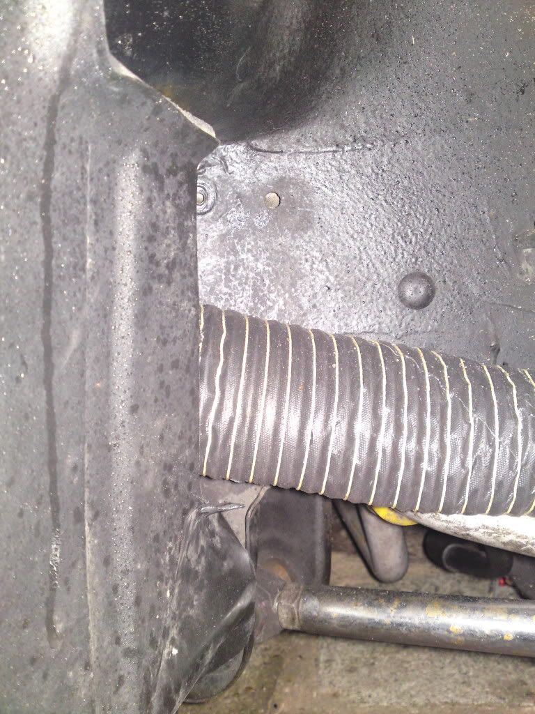

Heres where the hose tucks close to the inside arch and then through to the front bumper under the smics.

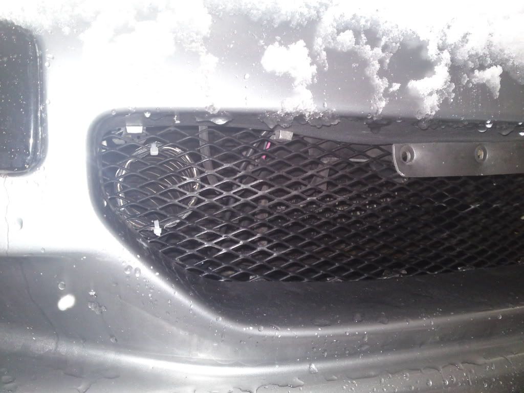

Heres where the cold air feed starts :D

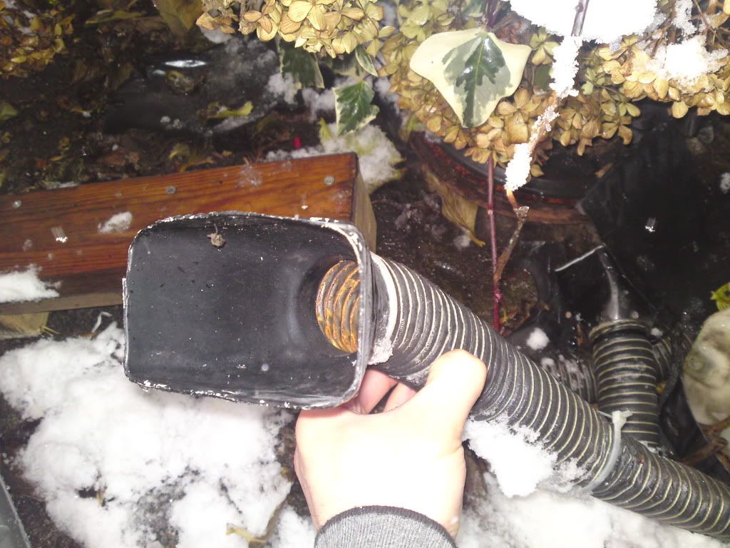

heres my old 2 inch hose with home made ducts which tbh is overkill with 2.5inch hose... plenty of air gets throgh.

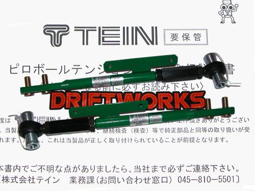

Jimmy do you have the air guides that mount to the forward facing tie-rods as well? If not well worth getting from a scrapper. I have some on my 90 import and I swear it made a difference when I left them off for a while.
na i havent, i know what ya talking bout tho, hmmmmmm anyone got some spare?
Ive seen the tein ones which are actually alot bigger and probbaly more effective....
Tbh would be easy to make, maybe 2 jubilee clips with a stainless steel sheet of metal welded to them?
Got any pics jim, maybe i could fabricate 'em.

ok heres what the brackets look like, you just gota make a plate to direct the air towards the brakes, thats the best pic i could find
aahhhh...... i see...... they are connected to the tension rods. Maybe i could manufacture them from precipitated aluminuim (heat treated in an oven at high tempurature for 12 hrs) the same, but with the lower part that is welded to the rod, slightly longer laterally, and use jubilee clamps to secure to the tension rods. What do you think?
Al.
Al.
no need to be heat ttreated, they wont come in contact with anything hot.
the rest sounds good.
The heat treatment will stop it flexing and bending, giving it a "like titanium" quality. The only thing i will need is approx. sizes. I need the height, width, hole pitch, etc... If you can get together some dimensions jim, i can get 'em fabricated by next week. (only rough dimensions buddy)
Al.
Al.
ok il try get some measurements but i cant promise anything not with all the snow we are having at the mo :(.
