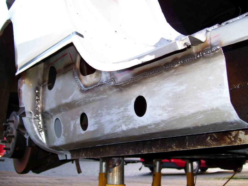

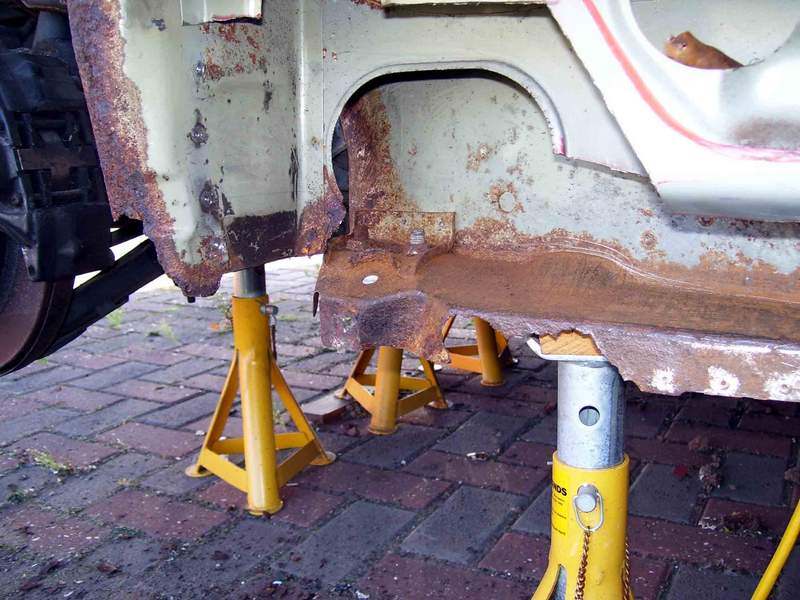

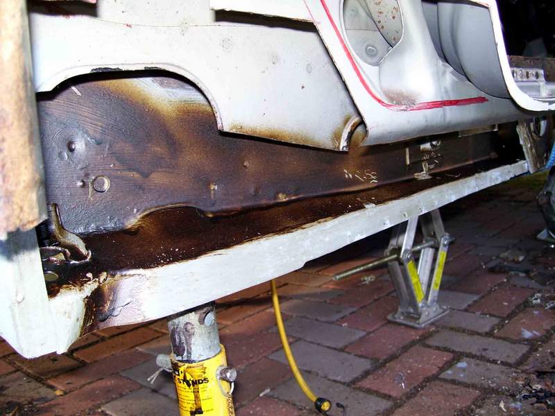

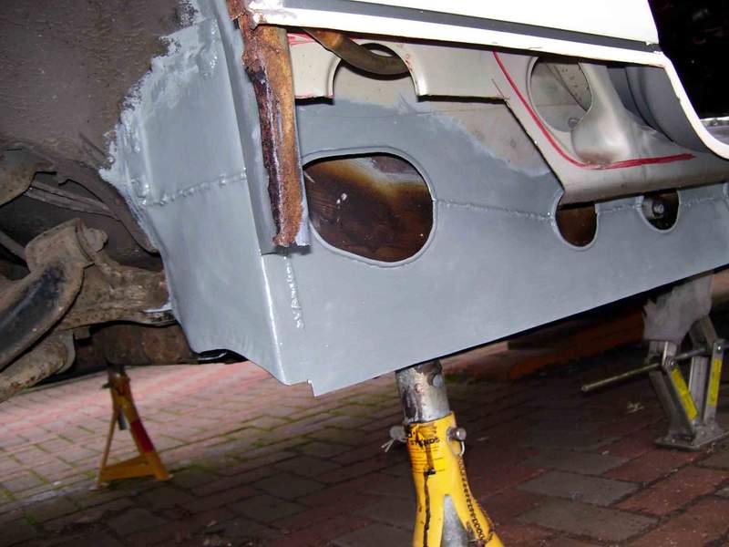

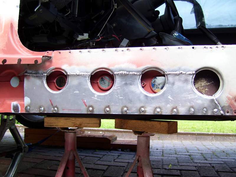

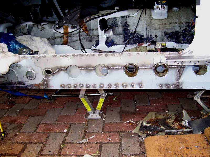

I am currently trying to restore my uk 300zx tt targa. Mainly the bodywork at the moment as the tin worm has done a good job on her. I am no expert by any stretch of the imagination but I am happy to share what little I know. Attached are a few pictures of my latest repairs.
Not sure I would trust myself on someone elses pride and joy. Still practicing. Some more repairs attached.:yawn:

some excelent fabrication there mate. i am doing similar work on a 200sx at the moment. damm rusty old datsuns.
Im sure you are on top of it but make sure you get rid of all traces of rust, once it starts its very hard to stop. soft wire brushes on an electric drill are very effective for getting out all the rust from the pitting. I have also had excelent results from the bilt humber deox range to get all those hard to get bits.
keep up the good work
Thanks for the comments Dougal200.:cool3: You are to right about the rust, seems to get every where. I to am a big fan of the bilt hamber range. One thing I have not decided on is the under seal to use. any suggestions?

I know what you mean about the rear arches. I have finished the near side and have just started the off side. I have attached some random photos of both sides. I am not familiar with por 15 or the acid prep so I will have to do some investigating.
As you, I use acid etch primmer and cover it with 90% zinc primmer. As for seam sealer I use a polyurethane type as I am told it helps to remove moister from the seam itself.

that all looks very familiar, as with the 200 they rust from the inside out.

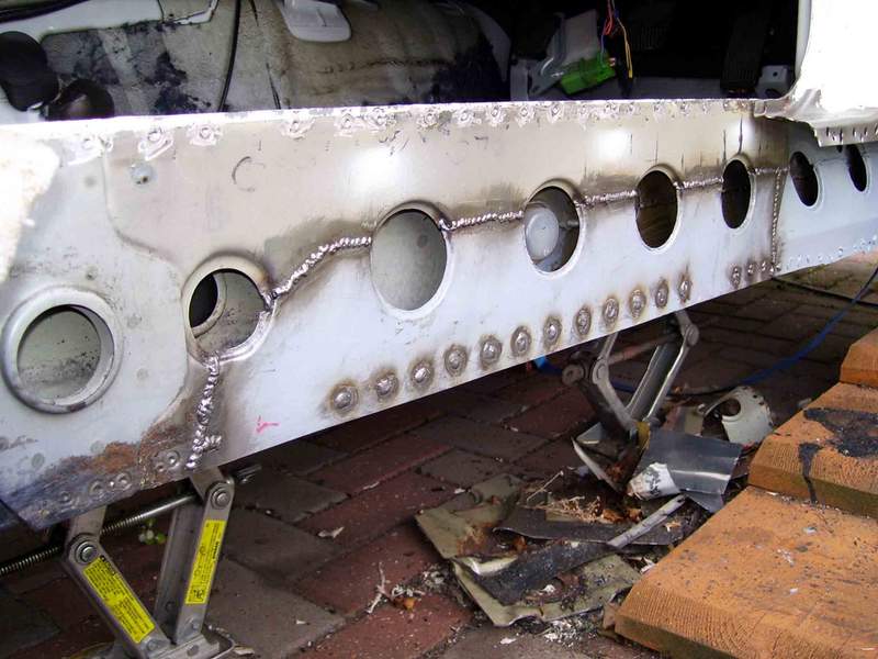

Have been mainly fabricating inner sill sections today, only minus 3 deg's. Still no one said it would be easy.
Managed to get a coat of acid etch primmer on my latest repair I just hope it will dry out.

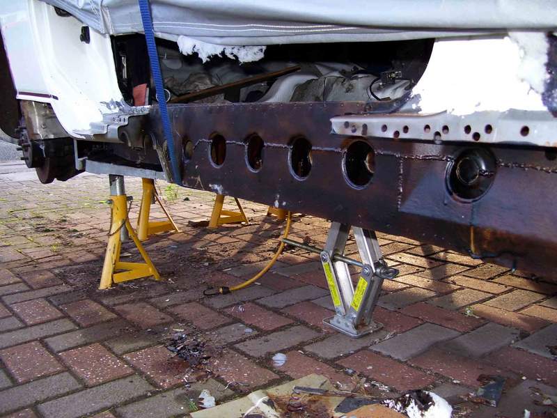

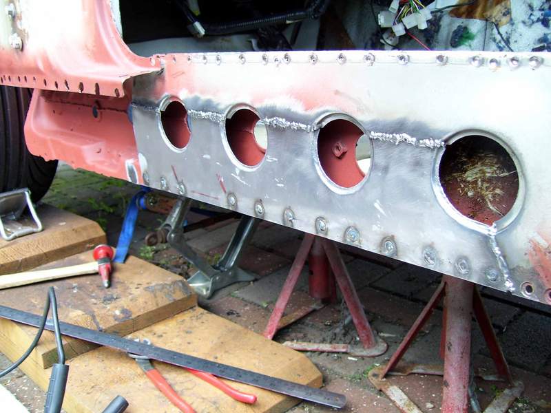

Managed to get the panel welded in today.:sweatdrop: Mig welding still leaves a lot to be dresired though.:blush: Ground back where needed and preped with acid etch primer followed with 90% Zinc primer. More wax to follow. Will it ever end!!

Well managed to get a bit more fresh metal into place.:biggrin: maybe one day all the tin worm will be gone?:no: possibly. So I thought I would post some pictures, if anyone is interested.:yinyang:
