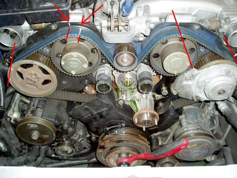

The zed in question is from Norway and has been to us previously ( last year ) that previous visit was prompted by the Nissan dealer who after changing the cambelt been unable to set the timing correctly?
In fact following the belt change the owner had tried several garages in both Norway and Germany to resolve the errant timing problem that was causing poor performance and using excessive fuel.
An Internet search brought him to us and we quickly identified a faulty cas unit that was retarding on acceleration and wandering on tickover, a £50 repair that cost him £1k in travel and air flights!!
Ok so sorted and happy again for 12 months, moving on its back with us via a container this time as the owner is too busy to drive it over, having a general service and again a performance problem, very , very lumpy and overfueling, locally again his garages unable to find the problem.
Ok no real biggy but easy to miss if the cambelt been changed by a dealer the previous year is considered a done deal.

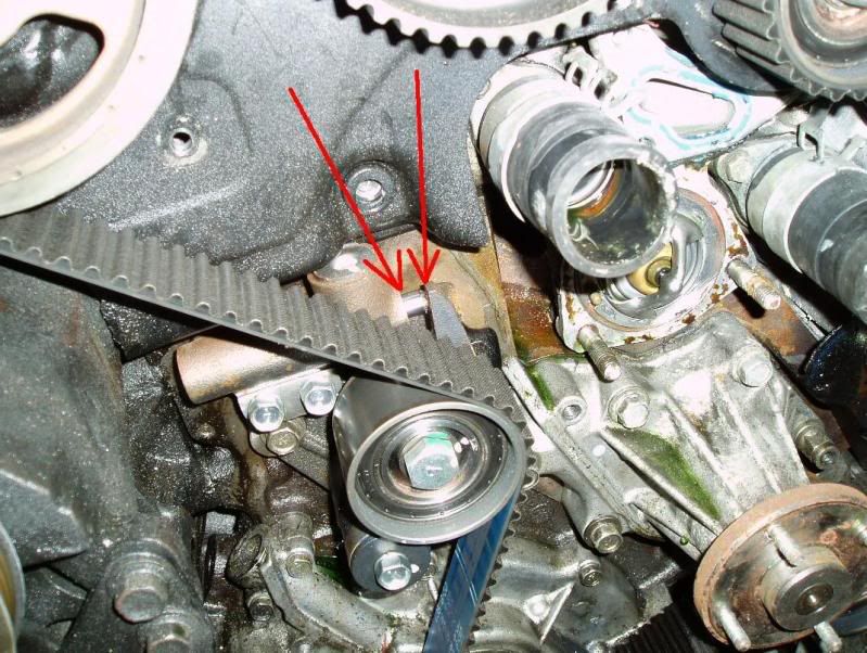

The first photo below reveals the problem, the cambelt timing on the inlet cam on the left is 3 teeth out, the belt a nice expensive Greedy one had been fitted with a new belt tensioner, but the tensioner base set position was incorrect meaning the adjuster had over the year become completely extended and unable to keep a good tension on the belt and had allowed the inlet timing to slip, the second photo shows the tensioner fully extended, the belt could be pulled off with out much force??? LUCKY !!
I know its seems like a pain but is well worth checking belt timing when odd engine issues occur that seem difficult to resolve with the normal checks and setting up, don't assume its correct because its been changed especially by a dealer:x:

perhaps you can enlighten me on a point jeff as I understand the cam belt marks are more important than the ref point on the backing plate as they are for ref only or have I got that wrong and p***ing in the wind and getting me feet wet
Yes your correct in your understanding that the relative positioning between the cambelt marks and the sprocket marks are essential and the backing plate simply a guide. But in the case highlighted above the left hand camshaft is so far out there is no question it been a slight variance with the backing plate markings the belt marking is over an inch shy of the set marks so easy to see.
Good point though, and happy to clear it up for you.
Jeff

Wow three teeth out! That must be almost on the verge of valve to piston contact Jeff

The crank and cam sprocket markings should line up every two full turns of the engine, the belt markings however will be about 10 thousand turns!!! :laugh: no seriously I have no idea how many actual turns you would never want to turn the engine by hand that many times.
When fitting a new belt both the belt, sprockets, and crank are all lined up, once turned you use the sprocket markings and crank as reference not the belt marking.
Hope that makes sense, if not will post some pics to explain.
