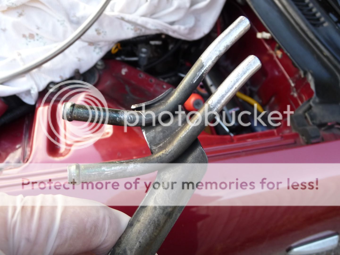

I had to go hard pipe to -06 stainless braided hose to JIC 0-6 to FPR and JIC/ braided stainless steel to Sytec Fuel filter with JIC -06 fittings.
To be on the safe side though I double clamped onto the hard pipes after cutting them down - piccy -

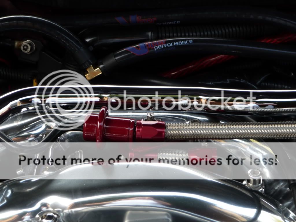

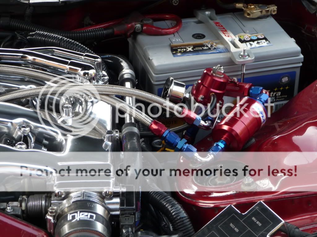

Cool.
Have you tried speedflow?
http://www.speedflowshop.co.uk/
I got a lot of bits from them when I upgraded my FPR and filter etc.
Here's some of their stuff in situ'
Andy
