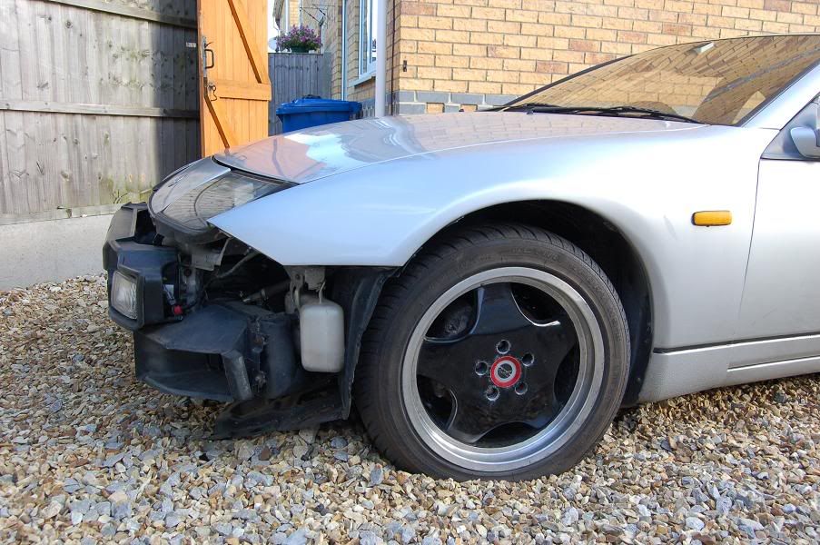

it apears that i dont have this panel,
apears i dont have it, or i dont know where that panel would clip onto?
i cannot balance the fogs into the bumper lol.
is there a name for it? or a pic to see if i could make something similar?
Sounds like the complete reinforcement bar that fits behind the front bumper - did you remove it when you took the failside one off?
yeh your missing the reinforcement bar, i removed mine to fit the fmic but idealy you need it
yea thats the bit.
when i baught the car the "failside" bumper was already off :wack:
looks like im missing the whole panel yes. obv i can see the seze of it,
what isit made of, heavy?
im trying to think where that panel bolts onto, as i cant imagine now??
bolts straight onto the front of the chassics.
think its made of some type of stong plastic dosent weight that much
bolts to the 2 bits underneath the headlights by the looks, heres a pic of the bumper off....
heres a pic of it - well side on but you get the idea.
