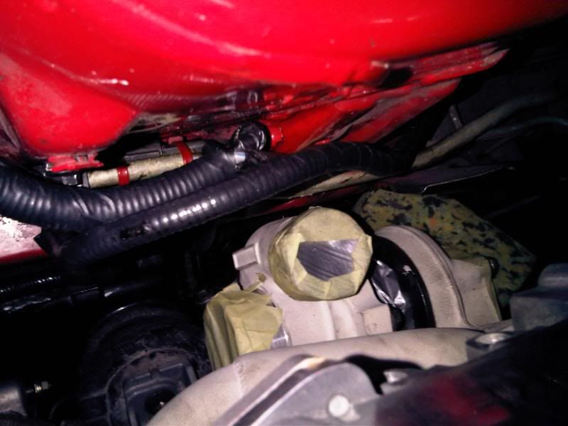

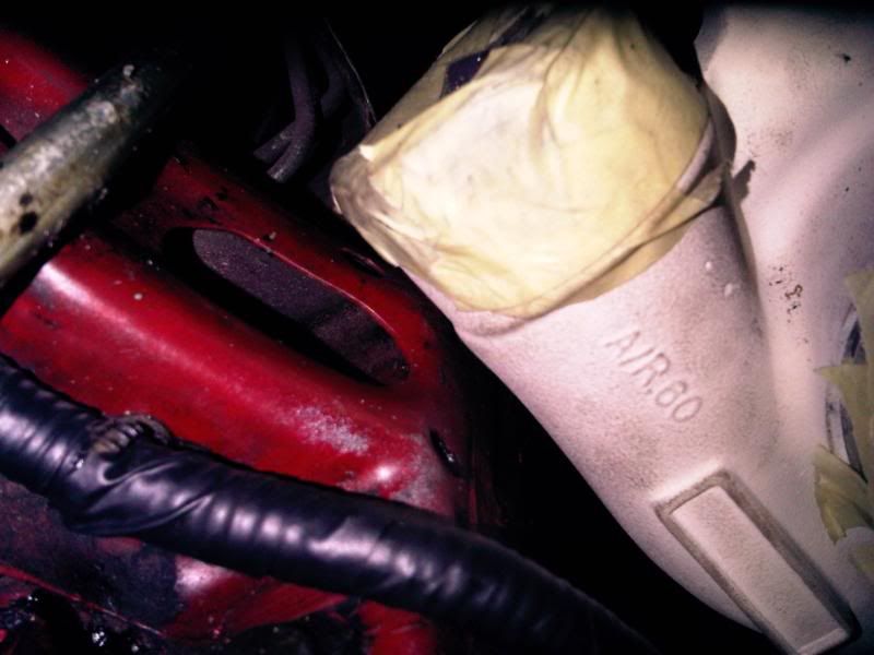

Im in need of some help here as you can see in the pics on the drivers side i have minimal room like 10/15mm:mac1:
What can i do??
Will it be enough for engine movement?
Thanks
Dan
LOL with my old turbos we had to knock in the inner wing to allow the turbos to fit LOL
10-15mm is more than enough for any movement bud :)
:shock: Really well i dont want to do that.
So you think the room i have will be ok?
Im just thinking with engine rock its going to be smashing the turbo?
What a relief :) I have new standard mounts i hear they are the best to have?
stock mounts are the best option for TT'd zeds. with poly mounts, there is a possibility that they will melt. you could go for solid ally mounts but, the ride will become very shakey.
you have plenty of room there. if you're still worried, use an engine brace...

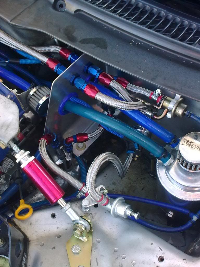

great picture there Silverbullet...
i see you have moved the fuel damper and regulator of the plenum great idea.

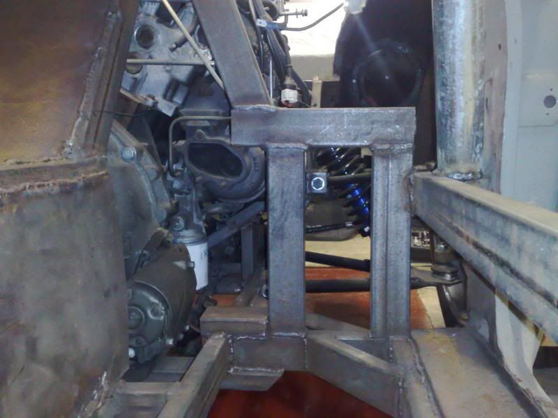

I had a look under Z1 Motorsports' 1400bhp (just upped the power again) vert and they've actually had to re-fabricate the chassis rails to fit the new turbos!

not sure on the make of the damper/brace, got it from concept Z.
my idea was to clear as much as possible off the plenum so it's easyer to remove and to hide all the fuel components behind the "fire wall" incase of any leaks
