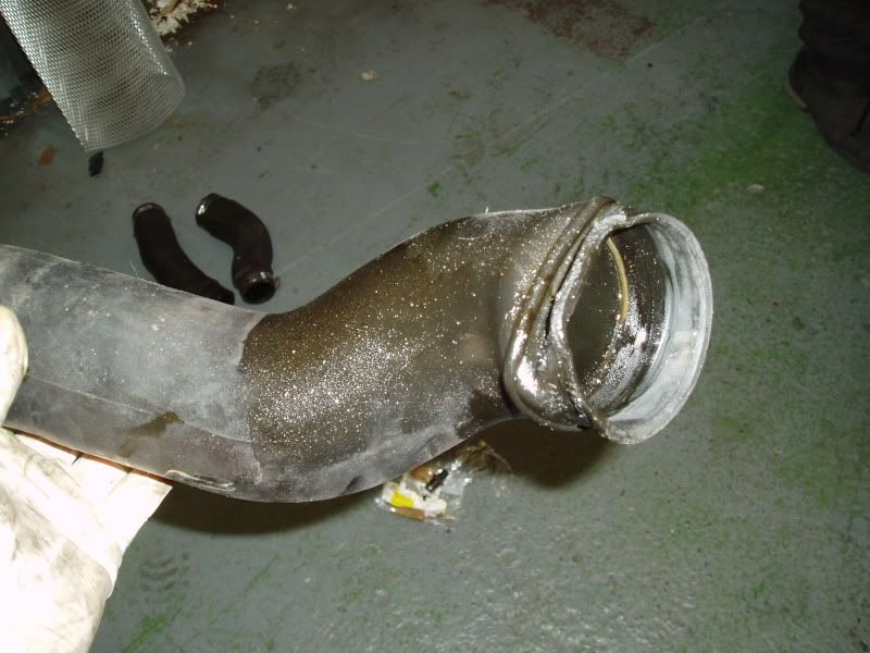

Boost leak !!
Boost / air leaks are often an issue when engines are changed or items removed when not enough care is not taken with all of the ducts and pipes, take a quick look at the photo below of a squashed pipe that had been mullered into place following some work done at a non specialist garage :x: the pipe had to be replaced as it could not be trusted.
