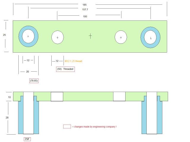

Here ya go, this is for brembos but the centre two holes are for the 300zx hubs s will suit just fine. By the way unless you deperately want Aston brakes why not just buy some Brembos from an Evo, use this drwaing and your way to go. PAds will be cheaper and you will get a pair of calipers for £150 or so from the mitsibushi lancer register forum classifieds

Is the drawing for the brackets the same for the front and rear? as in i could take that drawing to a company and just ak for 4 of them to be made?
the blue shade............is that a separate bit thats got to be screwed in or is it just cut around that, if you know what i mean?

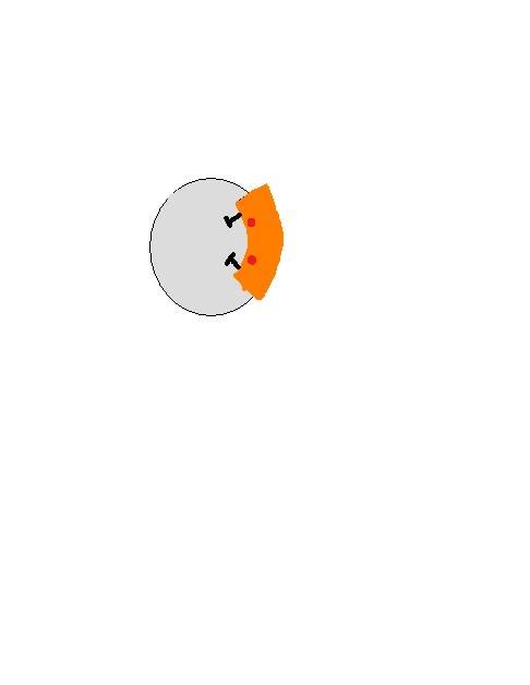

Radial mount calipers are bolted from the other face to stop flex in the bolt length. So basically the bolts go through the hub and into the caliper along their length so any stress is put on them in their complete length and give less chance of movement.
these are radial mount calipers
no bother.
i sent you an e-mail funky.
Im not much good on the computer but this might give a better idea. The circle is the disc and the orange is the caliper. The black fixings are meant to be the way the bolts would fix from the hub to the caliper in a radial mount so the stress goes thru the length of the bolt. The red dots would be bolt heads in the way a standard caliper fits into the hub. When under stress the standard way may mive the bolts with torque.
Does that make sense?
