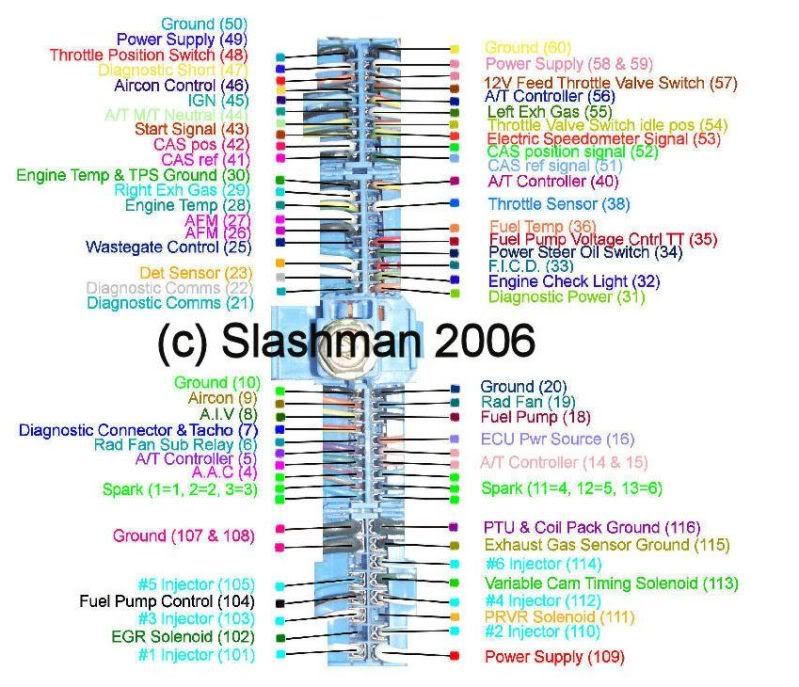

As above, anyone got an ecu wiring diagram, the one on the online service manual cuts off some of the pins and colour of wires.
If no one else comes up with anything in the meantime, I'll check out what I have on my PC at home, I've got four different manuals there :D something should help you out!
Not sure if this is any good, can't copy the thread address for some reason but search for 'ecu pinout diagram'
