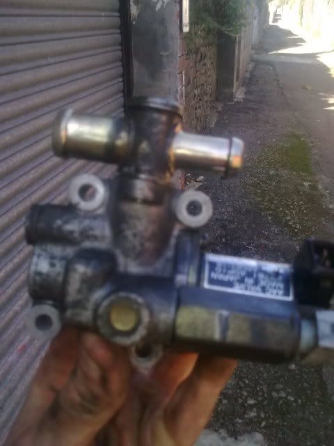

have an idle issue, so have removed the idle valve to give a clean etc.
the pipe that plugs into the IAA
stuck my finger in there, and its got black oil in there. quite thick aswel.
i presume these are the PCVs?
havent opend up the IAA yet, but i presume its gonna be full of that black oil aswell.

ive only taken the IAA valve off at the moment, to give that a clean.
havent done the PCVs yet, just stumbled across the oil in them when removing the idle valve.

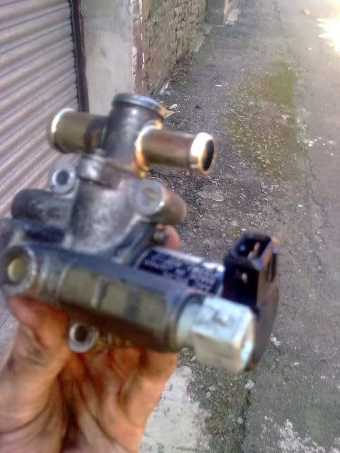

sorted now :)
car idles exelant, even after reving it stays, where as before it cut out.
cleaned the tottle bodies,
removed the idle valve/ACC/IAA.....
cleaned the terminals (scrape gunk & then WD40)
opend/seperated it, put few cotten buds in.
started car, was still dying. but then just turned the idle valve & was sorted after the first adjustment :)
dont be scared to turn it, no point just doing like half a turn, wont make no difference. good few turns to adjust
happy now, can try for an MOT :)

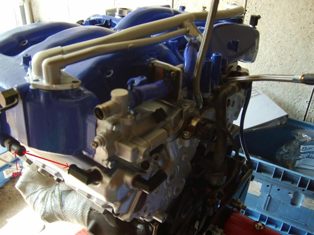

i presume these are the PCVs? NOT the pcvs.there close thuo but in the block the pcvs are about two inch long and screw into block ,try search TTZs of Dallas. ..

Underneath of the plenum actually, one either side :)
yes thats where i ment but coulnt think doh:rolleyes:
yea sorry, know where the actual valves are,
was refering to the pipe that goes from the PCV to the idle valve :)
the PCV pipe goes to the rocker cover, not the idle valve. the pipe from the idle goes to the compressor pipe

yes they do reduce heat and u can get them in any race - tune shop . ive managed to tide up my pcv as much as i could well ive deleted them and rerouted ventilation to oct and back to the intake .wouldnt recomend to ventilate it to athmospere ...
