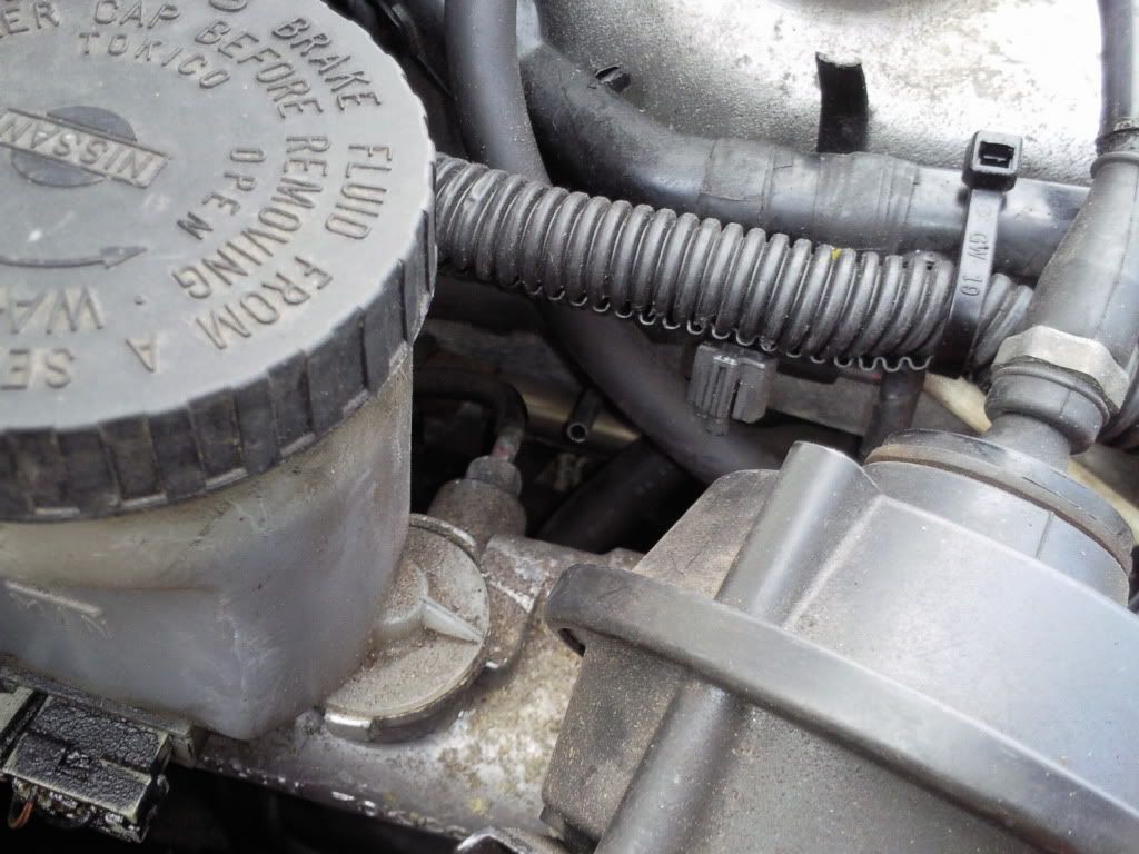

After finding the new vacuum line picture, which one should got to this pipe on the o/s of the engine??
Regards Andy
is it a vacuum even? can you hear it sucking?
im going to the garage now so will report back.
looks like a plastc/rubber pipe in your pic?

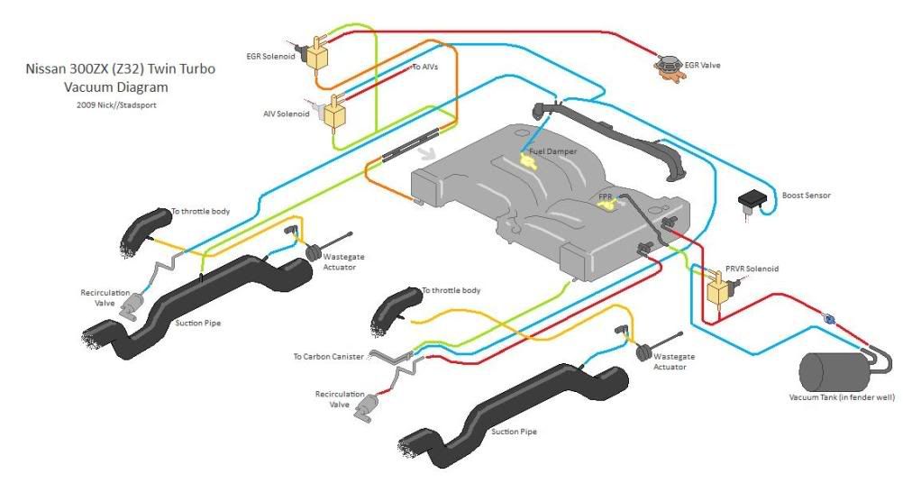

its defo got suction, just dont know what goes to it, i need to chase all those lines to make sure they are connected, found one once blocked off with a screw
anyone know where it goes? going to check all the pipe work now against the above pic so ill let you know if i get any left over lol
just checked and its coming from the egr valve going to that metal pipe, i then lose it under the plenum but reappears out the back then i think it goes to the egr valve. i did notice that the green and red lines on the PRVR valve was the wrong way round!!! would this cause any problems?
confused me slightly then mate,
ive been to look at my car, i have that one blocked off.
i beleive its for the EGR solenoid tho.
block it and you should be fine :)
you can then disconect the EGR solenoid & chuck it out.
think youl need to block the rubber pipe that comes from the EGR itslef tho (1 that goes from the EGR to the solenoid)
