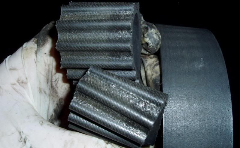

Take a look at the two photo`s bearing in mind the belt is removed and so is not under tension so would actually look better if still fitted added to the restricted view when in place.
The first picture showns both the top section and the underneath at the same time, this a luxury you do not have when its in place of course, either way its fair to say most viewers would concider leaving it well alone as in good order and replace the cover happy its been checked.

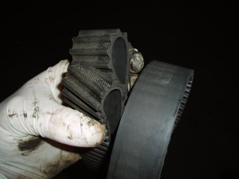

However now take a look at the second photo, this was taken at the same time but higher zoom.
Now more detail can be seen with crazing of the upper part of the belt but more important is the underneath section which now shows delamination of the belts outer materials between the teeth.
This belt is pobably not about to snap, but is well into the stages of failing, never take for granted the view of the belt when installed on the engine as its condition and estimated life left, if in doubt change it and use a genuine Nissan one too, a follow up post tomorrow will explain why.
