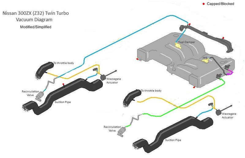

A good diagram of the vacuums - here :)
just found this on the american Z site,
looks good!

yes, it does make you "understand" the bay a lot more, helpfull for finding vav/boost leaks,
and also when removing some of the non required bits like AIV & FPRV etc
Thats excellent. Should be really helpfull to some.
I had a bit of a play with it, to show how it can be simplified, like I have done to my own Z :

the only thing i can see different is the boost sensor is on the other side but worth keeping for future reference.:duffer:

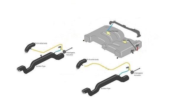

heres mine, even simpler! :)
AIV, FPRV, EGR, carbon canister, recircs deleted
there is another vacuum tho that apears to be missing off the initial diagram,
theres one on the drivers side, towards the back.

Same as mine but you ditched your recirc valves and blocked the pipes up ? Why ?
its not a good idea, when you shut off the excess boost pressure is sent through the Turbine blades causing them to decelerate - which reduces turbo life and increases lag between gear changes.

legrath,
i experimented with them before, kept the re-circs in, but just removed the return hose from them (pipe that goes from the recirc to the air filter intake)
they sounded like mini HKS SSQV :)
when i did my NA to TT conversion, it was quite a nightmare getting the intercooler pipes back in, its so tight down there, along with the oil cooler there etc, was easier just to remove & block them off to get them in.
and thats with the air-con rad removed aswel!
am aware of the compressor stall issue, but Nissan make several cars without re-circs so think its just more over-engineering they did :rolleyes:
(PS i know thats a whole different debate so lets try not to hijack the thread :wack: )
