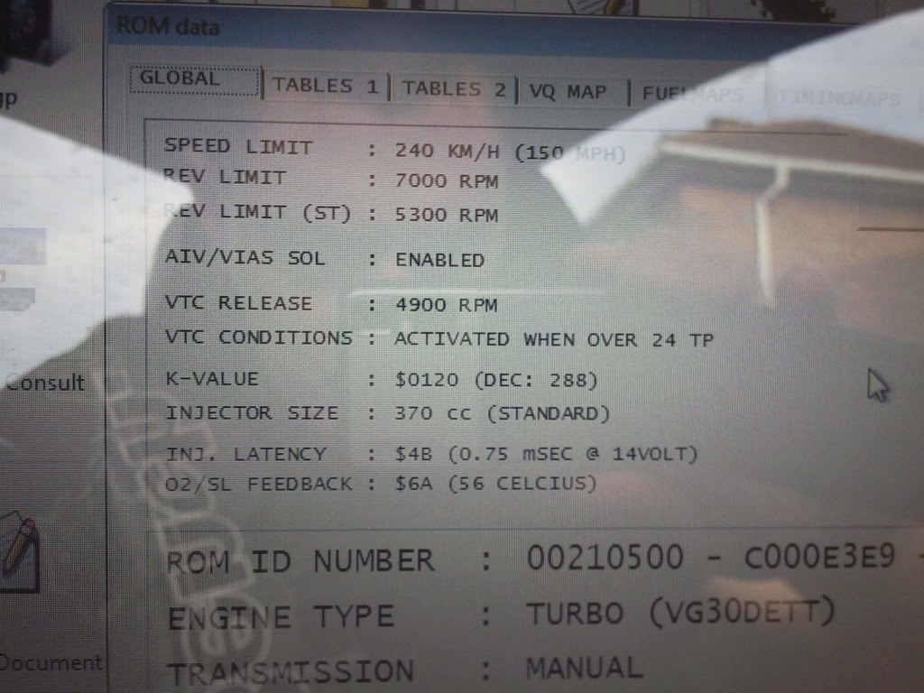

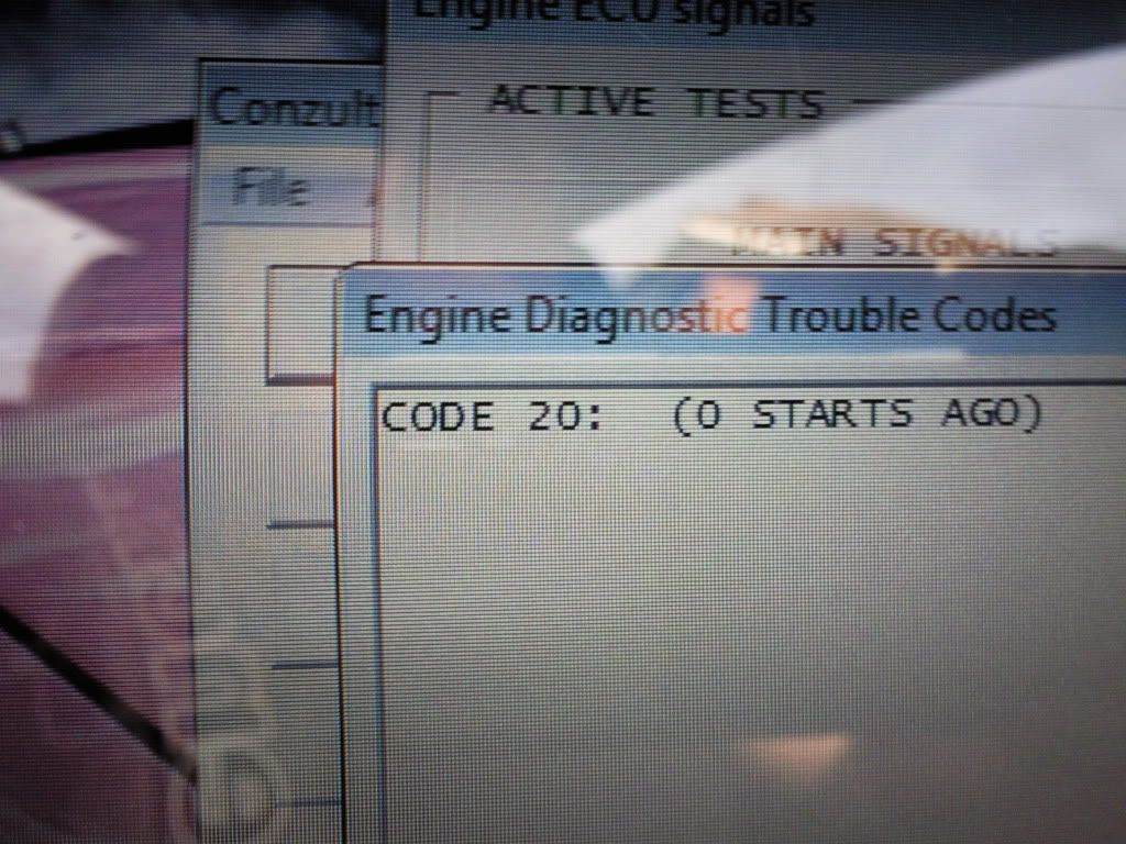

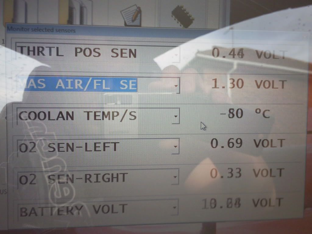

Hi All. Just got back in after finally getting conzult to work and i thought i would be best to take some vids and pictures. the software still freezes after about 20secs of using it but i thinking there is a problem with the ecu. everytime i connect with the software i get different ecu number. also the vehicle thinks it a manual??
here are the vids and pics, see what you make of them. also i get different fault codes all the time and the data is always jumping.

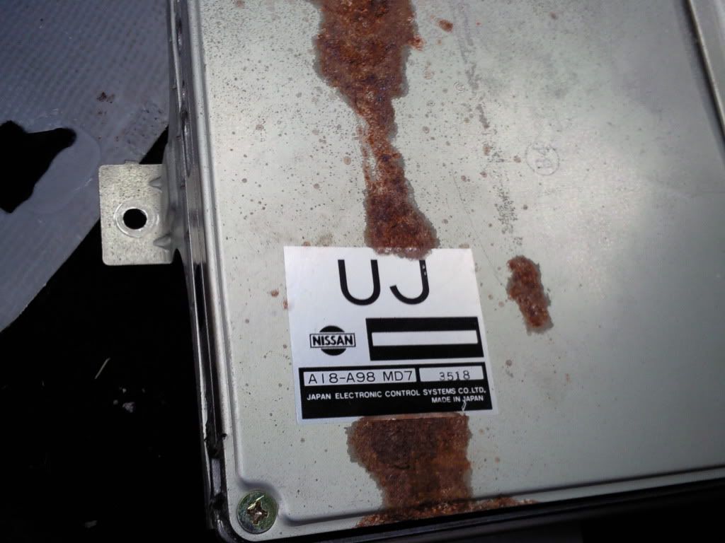

open the ecu and take alook inside..
could even be a little water damage,going off the rust mark on the outer case
look for tampering on the board or any white marks(like limescale)as this could point to a malfunction
what do you think of the video when it shows on o2 sensor at half way and the other only at 1/4? these are both new sensors
yes, opened it up and looked like water has been inside too, but cleaned what i could but made no difference. theres no dampness anywhere else looks like an old leak or something. im worried the ecu thinks its a manual tho not an auto
the "jumping" numbers/bars can indicate a dodgy USb converter or connection.
Best is to try it on another Zed, to see if the software behaves better.
If it does, it's your ECU..if it doesn't, it's the laptop/cable/USB-converter
if the conzult indicates the ECU is for a manual it's safe to assume that's correct
but I can look it up for you to be sure, what's the exact partnumber of the ECU ?
sometimes it's written on the ecu, otherwise get it through the software
it's a number which look like: 23710-xxxxx
