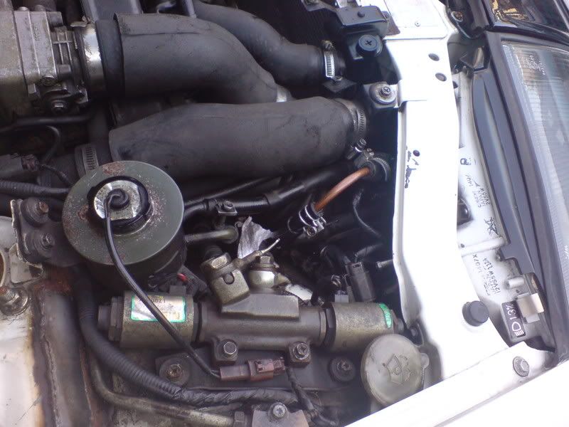

August 28, 200917 yr post a pic mate, is it being joined at the back, ask dtuk about it (danny), easily solved if it is, just join at the front i joined mine like this (where the copper pipe is), but looking at the pic the bit that goes into the left of the pipe needs a olive niping on as its a bit thicker than the pipe on the left (if that makes sence lol)
August 28, 200917 yr Haven't got a clue how it will go tbh mate, I haven't really looked into it yet. I worked out what to do with the mechanical side but wasn't sure about the fluid lines. Here's a pic of what I've got.
August 28, 200917 yr yup sure that is the wrong one, looks like the one i got to couple the pipes at the back
