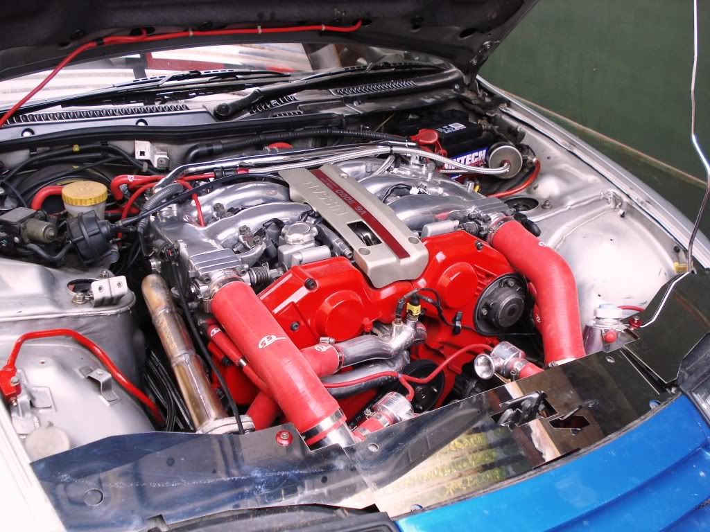

It's been a long time since I've done an update on the project, things have been a little slow due to lack of time but there has been progress.

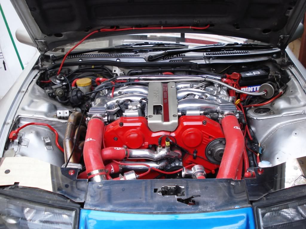

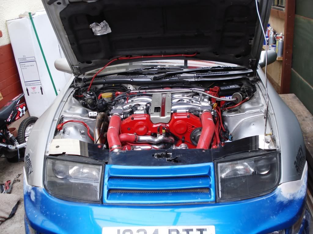

Apart from trying to source a slightly larger radiator as I'm not completely happy with the running temperature things are pretty much done. There are few little running issues that need addressing but I can't do anymore and have booked it in with Jeff. It is either a software problem or something simple that a conzult session will cure. Some pics but the engine bay needs a good clean as it's covered in filler dust!

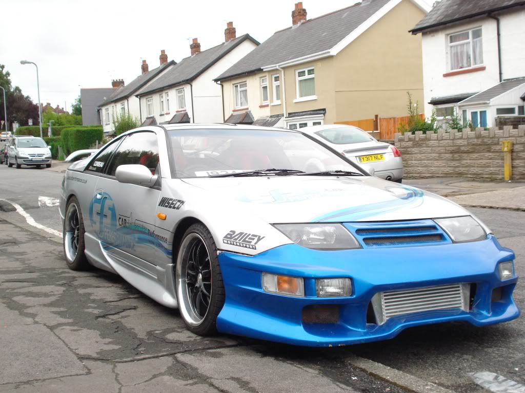

The prep on the bumper is going well, until the car is running 100% I am only going to colour match and paint it using aerosol paint. I'll get a full respray done at a later date.

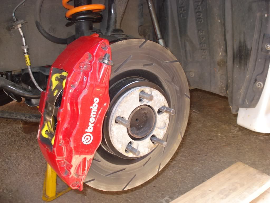

The brakes are all done on the front as well, all I have left to do is fit the rear uprated discs and pads. Then some rear adjustable cambers arms and camber adjustmant kit for the front.

very interesting, bet its been enjoyable, what bhp you going for?
I would like 500+ but I'll see how it goes.
looking good mate. will be good to see the dyno results
Me to but only when Jeff has made sure things are set up correct, I can't be playing with conzult anymore- time for the pro!
Just sorting out a bigger rad and the ebc as the external wategate is running without one at the moment with a 11psi spring. Mind you just realise the vacuum line on the wastegate is plumbed in wrong :slap: so I don't think I'm even getting 11psi at the moment.
