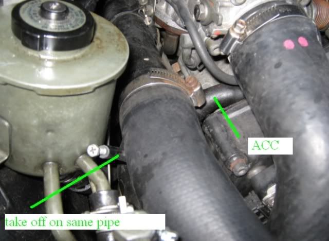

PS that AAC,
is that on each side? or that only on 1 side.
ive got that blocked off on the drivers side, maybe why its idle'ing crap?
need to check the passanger side :confused:

there is a take off on the RUBBER pipe on the drivers side, its the same pipe as ACC vale is on (pic above)
i asume this is acceptable to put the drivers side wastegate pipe to???
isit?
those 2 above are on the large rubber one that go from the air filter to the turbo.
where can i connect the actuator to on the drivers side then?
there defo isnt a take-off on the intercooler like the passanger side
