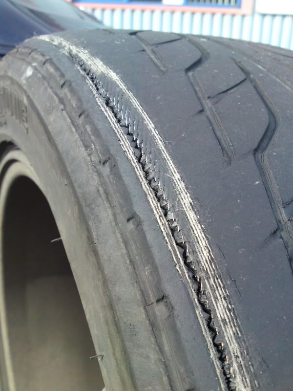

as i have now got my new wheels on (cruize 135s) it was time to get my current ones onto my dads (stonewall) Z....
however he had a rather nasty suprise when he took of 1 of he's front wheels :shock:
rather lucky escape...

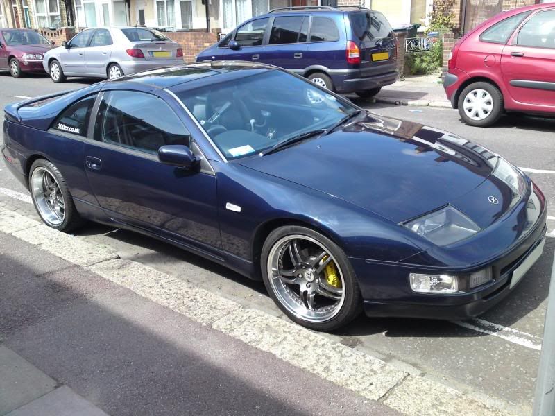

and heres a pic of he's Z looking much better with some new shoes on
