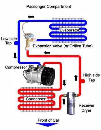

Below is a brief diagram of a system. This is how it works
The compressor compresses the gas to a liquid (the high pressure side)and pushes it through the condensor (condensor is in front of the rad) and then through a drier, it then goes thru a TXV or OT, as it goes through there it goes into vacuum and into the evaporator, this drop in pressure causes the liquid to turn into a gas by "boiling off" taking the heat from the surrounding area as energy, the fan then blows the cold air around the car. And then rinse and repeat

Yes sounds like it. So if the compressor is clutching in then the clutch and controls appear to be ok, so next step is to see if you get any temperature drop at all in the cab. Put it on full cold, med fan and centre vents. You should get anything around 6deg at the vent any lower and it may freeze at the evap. Up to 10deg at the vents is acceptable on an old car with change of refrigerant.
If not a couple of things could be wrong.
1. The guts of the compressor are shot and its not compressing
2. you have a blockage before the TXV not allowing refrigerant into the cab
3. Electronics are up the duff and not sending the right signals.
So 1st port of call is to let the system run and see if the clutch cuts in and out regularly (anything around 30secs intervals). If it clutches in and out much quicker than that it is likely you have a blockage or insufficient or excess gas in the system.
Make that your next test.
Start the car again put the system on and time the clutching in and out (the clunking)
Mike
Also check to see when the auxiliary fan cuts in.
