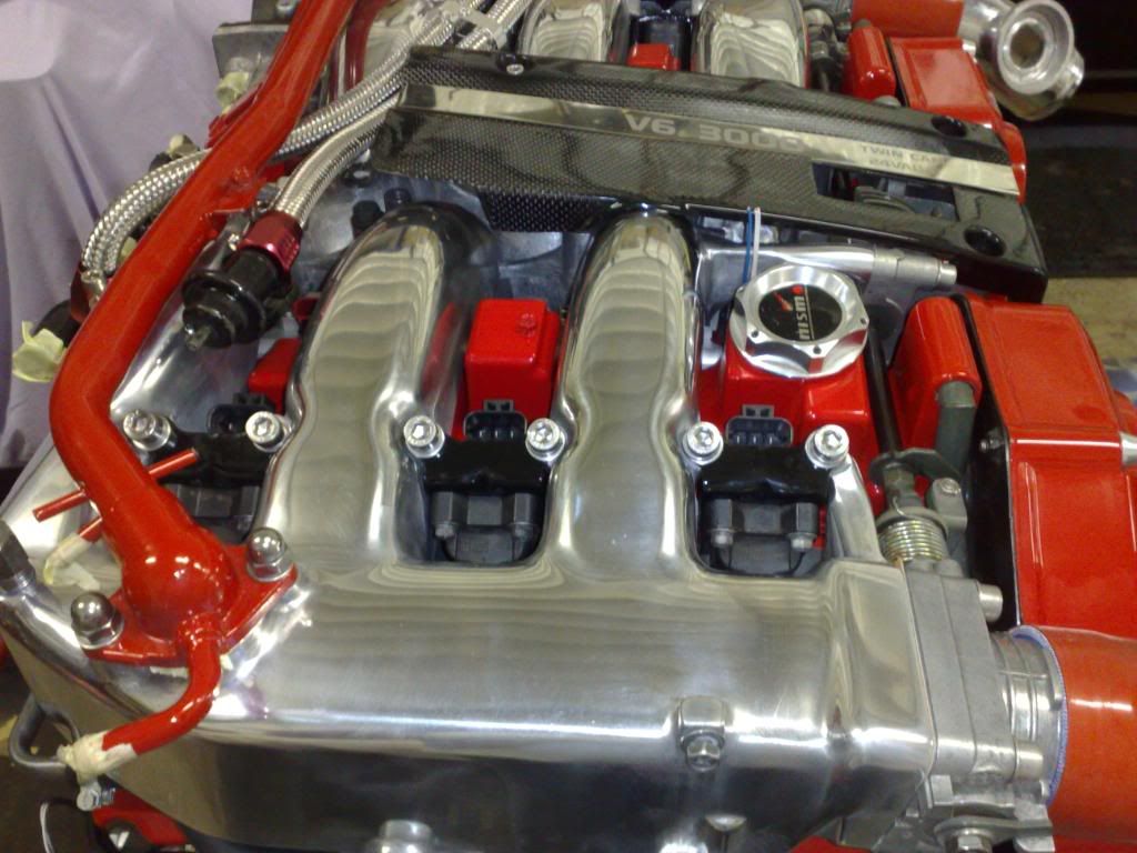

Ive finallyn early finished the engine apart from the actuator problem what do you think so far :confused:

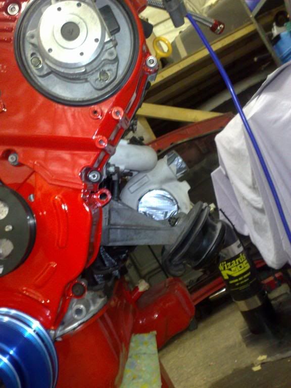

Another problem any ideas on this???

Looking good. are those the bigger Z1 throttle bodies ?
You'll need to cut/grind away enough of that engine mount to give you clearance.

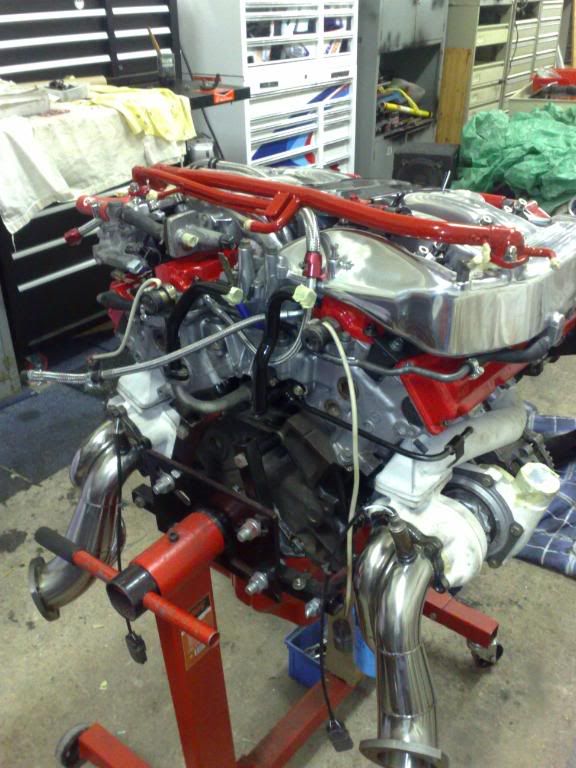

What tubs are they ?

Legarth they are the GT28rs tubs with Gregg Dupree manifolds, the throttle bodies are standard size ive just matched the plenum intake to the same size bore as the throttle body. I know its not much but every little helps:dance:
The engine mount in that picture if i was to grind away enough to fit the needed pipe work i think the mount would be to weak and would prob collapse. Alot has got to come off on that side.
Strange as the left handside only needs minimal grinding :confused:
Can anyone give me some ideas on fitting my actuators?
Ive got the smaller HKS type but the way the manifolds sit i have no room to locate them in the position most people do with this type turbo??
I dont want to mess around with the manifolds or ceramic coating to fit external waste gates:x:
