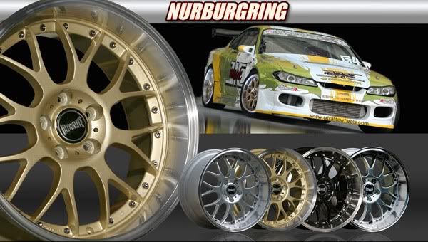

Scratching my head a bit. will these wheels clear my brakes?
who knows?
seems as though this may be a risk, i dont think there is anyway to tell :(
I want to buy these ultralite nurburgring wheels 9.5 et20 all round, the spoke design looks as though they may touch my brakes......
anyone have these fitted with the 9.5 front and can tell me how much they cleared the stock brakes?
btw if anyone mentions anything about them rubbing my arch with that offset i will shoot you. :nono::p thanks

hmmmm, i did ring them today but forgot to ask... im not sure if id be able to make any sense of the dimensions tho, its all a bit daunting. the spokes are never straight they always curve in or out, Well i might aswell try :nelson:
There are some replicas on ebay and iirc some one said they wouldnt clear the stock calipers :(
Stunning looing wheel :cool:

cheap chinese copies on ebay, probably have really fat heavy spokes and a small offset, u got a link maybe?

I have these wheels and they'll clear stock brakes and 350Z/GT-R brakes without spacers.
I now have a Brembo GT brakekit (355mm rotors) and needed a small 8mm spacer to clear the calipers

well i just learnt something new today, speaking to the ultralites people they told me every wheel has an x factor measurent which basically means how far away the hub face is from the centre of the spoke. the 9.5j et20 has an x factor of 58mm which is massive so i can use this to calculate the clearance from the caliper to the hub face or something like that. :D its looking promising.
