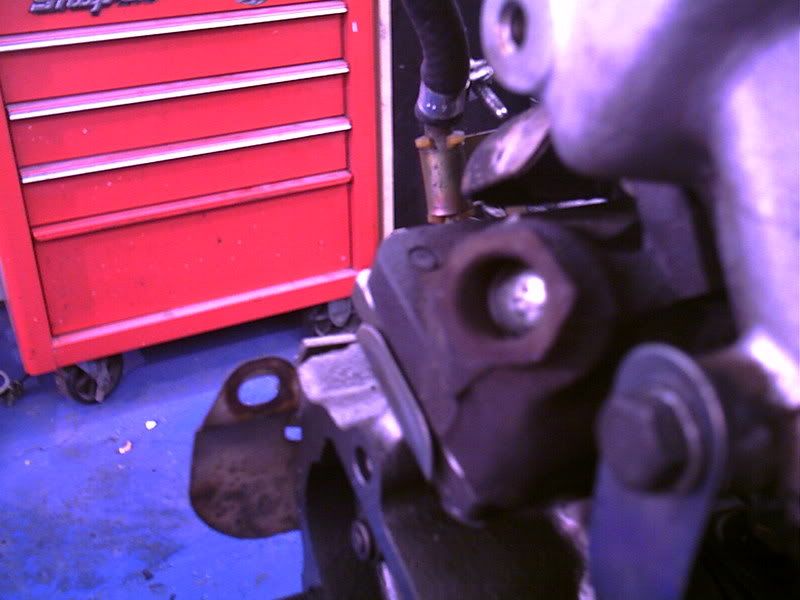

I removed the down pipe and used a hack saw to cut off the pipe. Then used a blank that i got with the 300 degree egr delete kit. I didn’t have the plenum off so the egr and some of the pipes are in situ but completely bypassed.
Thanks Paul - That's my Pan 'B' ;-))
Also doing the PCV re-route now as well - jeeeez.
I cut the pipe on mine to be able to remove the nut that holds it , it has a flare on the end so it,s the only way of removing the nut and for a blanking plug i used a 5pence piece as it was the perfect size , Drop it in the hole and tighten the nut down onto it , job done. !! HTH
If you got the plenum off then it should be straight forward to remove the EGR to Plenum pipe work from the EGR valve (4 Bolts). If i was doing it i would leave the EGR bolted to the inlet manifold so its solid and drench both ends of the EGR to Exhaust Manifold pipe in Plus gas (Dismantling lub). the EGR side should be straight forward but you might have trouble with the exhaust side if it is completely rusted in.
Plan 'B' would be to cut this pipe close to the EGR valve (only thin wall) then crimp it over.
to remove the pipe to the manifold I cut it close to the fitting then got a socket over the end, came off with a bit of force.
... thanks guys - I know where I am now - appreciated as ever. ;-)
just a note on the 5p. I did this with mine also but make sure you're careful as i manged to crack the coin with the heat and tension and then it rattled loose. I cured it by removing the bolt and pool welding the hole (with 5p still in place). I also used 5p's pool welded in to adapt the original plenum mounts after cutting and grinding the plates flat.
