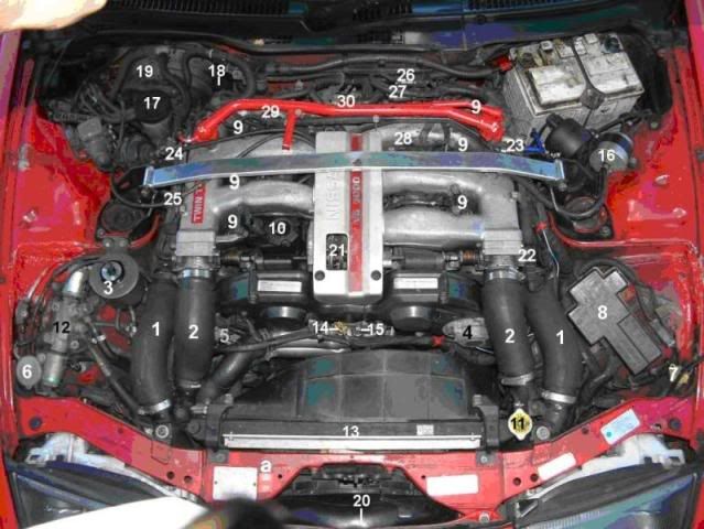

Take a pic of the connector and post it up (take the cap off first).
Should be a light blue cap engine bay nearside just near the inner arch. It will be on a small bore aluminium pipe
Once its posted i'll tell you whether its the later refrigerant or not
Better still its right by the number 23 on here, if it looks EXACTLY like tyre valve it is old style if it is not (hard to explain but its a quick release fitting) then its the new type. Finally mines a 1994 and its new refrigerant from factory hasnt been converted. HTH
Cheers for the advice gents, have checked just now, just below the dipstick there is two plastic cover, a blue one, on a alu pipe low down, and also a red newer looking one an ali bore pipe of about 10mm,
This red one is a push fit style connector.

If its a push fit then it will be new gas so your half way there. Easiest and first port of call is to check that its gassed. Find an aircon specialist though not Kwik Fit
