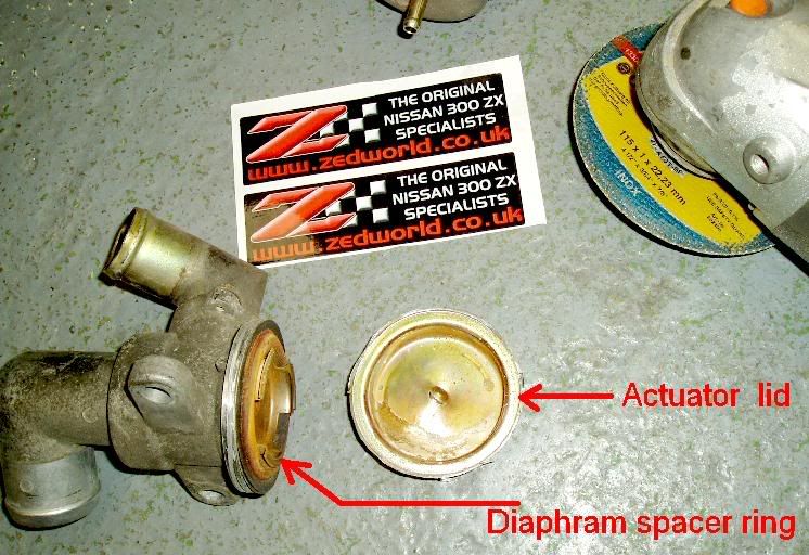

Recircs ( see pic below ) operate by been piped either side of the turbo or in simple terms form a regulated short cut from the turbo output back to the turbo input.
Here I have removed the lid of the recirc to reveal the diaphragm that rises and falls by the vacuum generated within the intake( plenum ) the diaphragm then acts upon the spring loaded plunger which itself is connected to the valve disc, this is positioned so that the in and out ports can be opened ( when throttle closed ) or closed fully ( when on the gas).

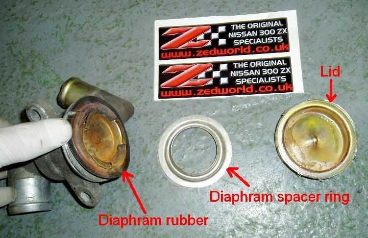

The top and spacer ring removed in the next photo reveals the diaphragm rubber seal, this isolates ( seals ) the top section from the bottom and means the vacuum will draw the diaphragm up and pull the plunger rod etc.

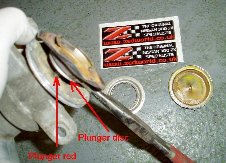

In the next photo the plunger is held up to show the lift angle and the plunger rod below.

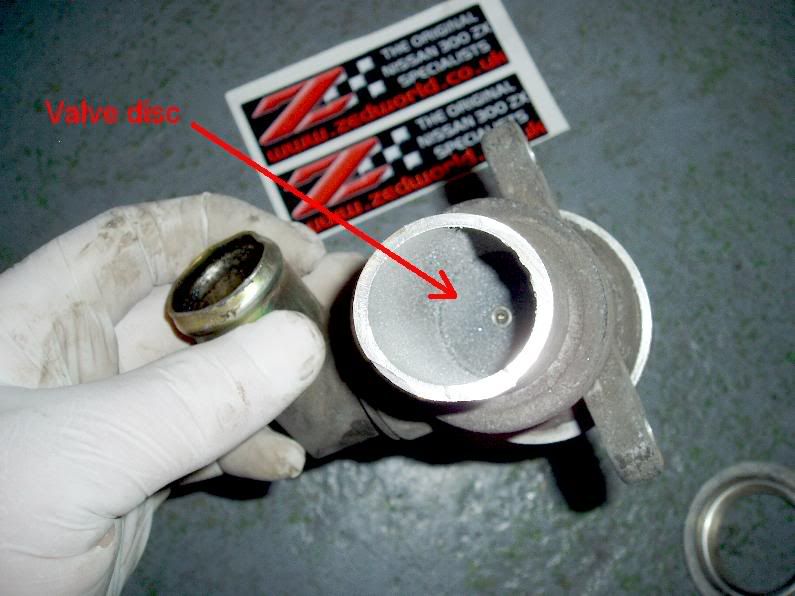

By cutting off the lower section elbow it is possible to see the actual valve which is connected to the plunger rod and moved by the actuator diaphragm.

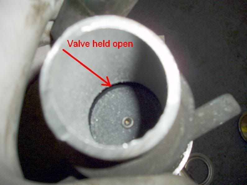

In the next photo the rod is been held in the full lift ( high vacuum, over run etc. ) the valve disc can be seen open.

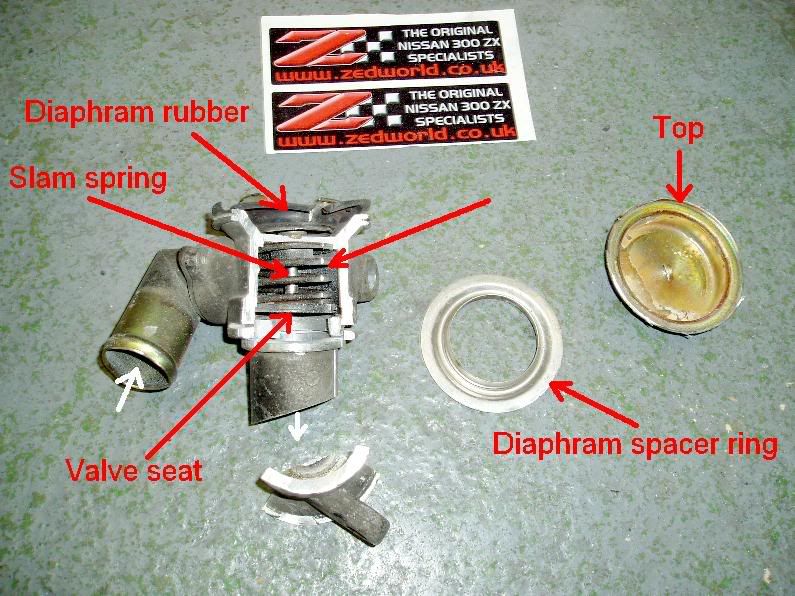

Finally cutting the side out reveals all of the above in one go and allows a clearer understanding of what is happening.
The recircs as mentioned have a slam spring which has a pre-load effect upon the valve, however the vacuum produced at tick over lifts the valve and for this reason this kind of unit cannot be used to dump to atmosphere as it would be the cause of a big air leak and not forgetting the zed is equipped with an air flow meter this would cause fuelling errors too, this is where piston type bovs ( dump valves ) are required as they do not lift at soft idle conditions.
