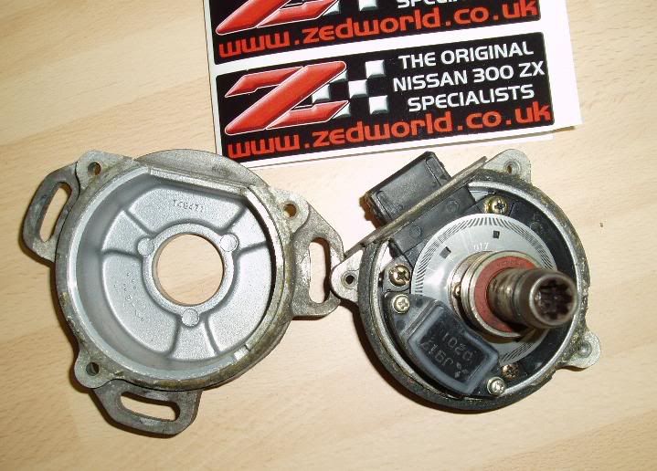

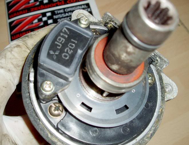

To know how it does this take a look at the photo's, the reluctor disc has a series of slits and gaps which rotates at cam speed (half engine speed) the disc passes through the pick up sensor, within this sensor is light emitting diode one side of the disc and the other side a light receiving device. As the disc spins the light passes through the series of slits and gaps and fall on to the receiver which produces a signal output at the pick up which is then sent to the ecu to interpret the information and trigger the injectors and ignition coils accordingly.
If you take a more careful look at the reluctor disc it can be seen that the larger gaps are not evenly spaced which initially would look incorrect however quite the opposite, by doing this the ecu can not only calculate when to trigger the coil packs and injectors but gives it the information to know exactly what the position the engine is to a very fine degree.

Finally in the photo you can see the rear bearing, this can be the cause of many timing issues from signal drifting to noise by audible and electronic interference noise.
