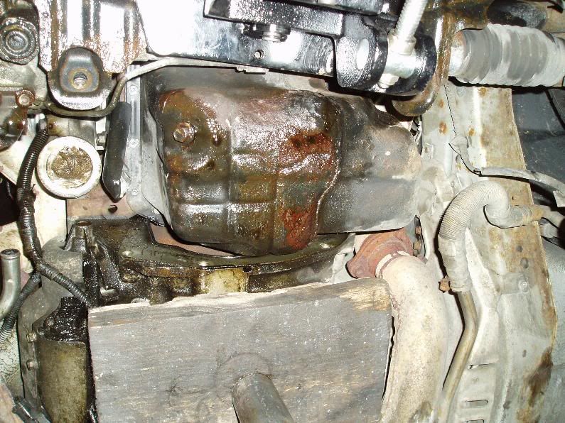

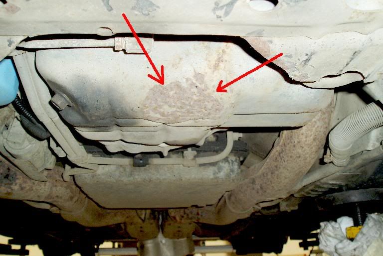

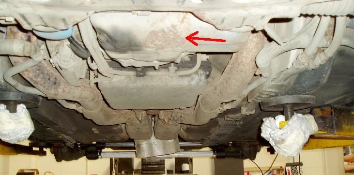

Warning to all zed owners but in particular UK spec ones, started to see a worrying increase in corrosion issues with engine sumps, the first two photos show how it starts, eventually as seen in the last photo the sump becomes very thin and porous, replacement is the only answer which can be costly in labour as well as a new sump pan.
So if you have noticed an oil leak under the engine and an oily sump pan check it out , and anyone who has not got a leak yet, check your sump pan for corrosion and treat it asap.
