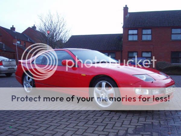

Is my car AG2 colour?
i want to paint my new spoiler but im a bit unsure of the right colour code.. shes dec 93 and heres a pic
also where would be the best place to buy the paint? any online places for this?
thanks

your better off getting the bodyshop to match it as the colour prolly wont resemble the oem colour any more...
Yes, that would be AG2 but do check your VIN plate, I dont know if they changed the code at any point.
But you really should take something in like your petrol filler cap to get them to match it to your car, red in particular changes colour from its original a lot over the years
better getting body shop to match it
ag2 probably wont match up now too old
I doubt it's AG2 on a 1993 - I think that was the red for series 1 cars.
IIRC a 1993 UK spec car would be AJ4 - Flame Red; according to the Nissan Brochure.
Richard:)
hmm think I'll just drive the car down and let the boys take a look at it.
theres 2 ag2's one has more yellow than the other
Correct the other has more blue in the mix. Make sure you get the right one! its as different as black and white
