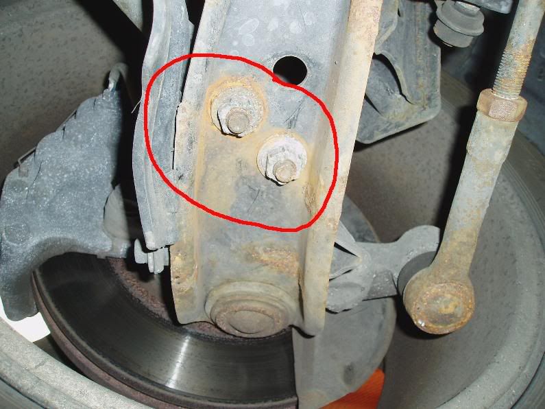

More words of warning about loose nuts, not a new warning but here are a couple of photos of how loose nuts on tension rod arms to lower suspension arms look.
The rusty marks around the nuts show the extent of movement on this particular zed, clonking when braking or even accelerating is the symptom of this, the holes through the lower arms had worn oval shaped and required replacement, catch them before this and its just a case of tightening them.
