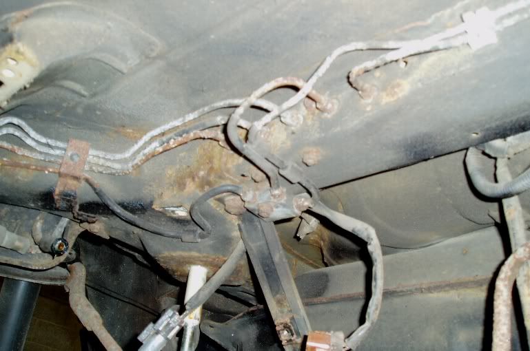

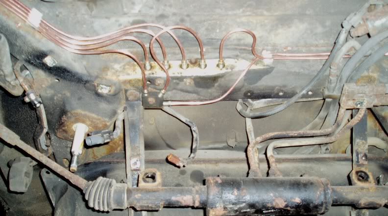

Brake pipes at the rear are very inaccessible requiring diff / sub frame removal, the ABS unit is in the boot and all the pipes have to go there and back out to the calipers, the photo show before and after replacement, typical cost is £350 to £400
