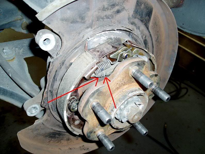

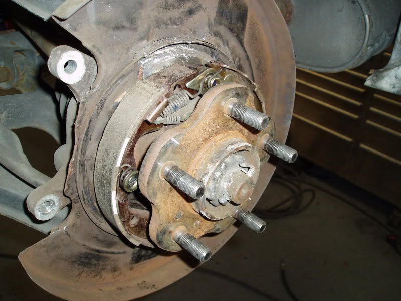

Whats wrong here then, tech game
Ok guys who knows whats wrong in the photo`s? will tell the story that goes with it when someone guesses correctly.

oh yeh LOL, I did'nt even notice that.
The guide plate was still upside down as well though, but not nearly as important LOL
Yep seems who ever had them apart last time did not noticed they had bits left over when complete! see here with the struts fitted.
The handbrake shoes could not operate as they had no expansion leverage, the car had come from a used car dealer recently with .....FULL MOT :shock:unreal, some years ago I warned of a cluster of car dealers in Birmingham who where selling dodgy zeds, they have been quiet of recent times but hey ho they are back.
The handbrake shoes could not operate as they had no expansion leverage, the car had come from a used car dealer recently with .....FULL MOT :shock:unreal, some years ago I warned of a cluster of car dealers in Birmingham who where selling dodgy zeds, they have been quiet of recent times but hey ho their back.

Phew, not mine then ............ had me worried
Jeff TT
Brake caliper+brake hose left unsupported?
Was in for full brake overall including braided hoses, brembo rear calipers, etc.:rolleyes:
