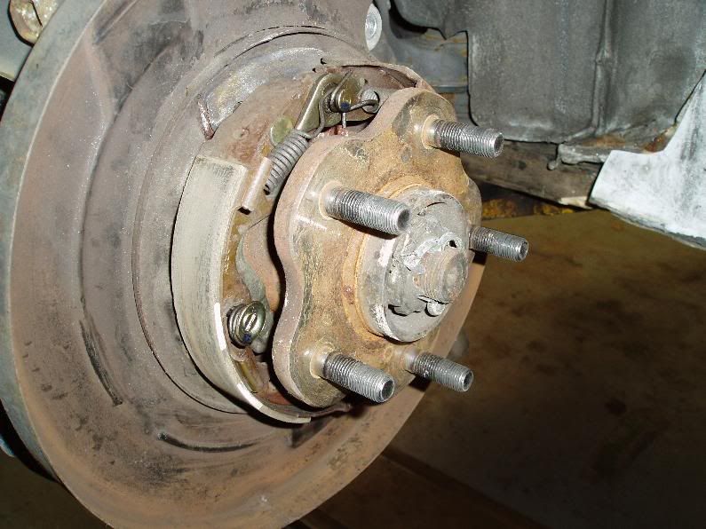

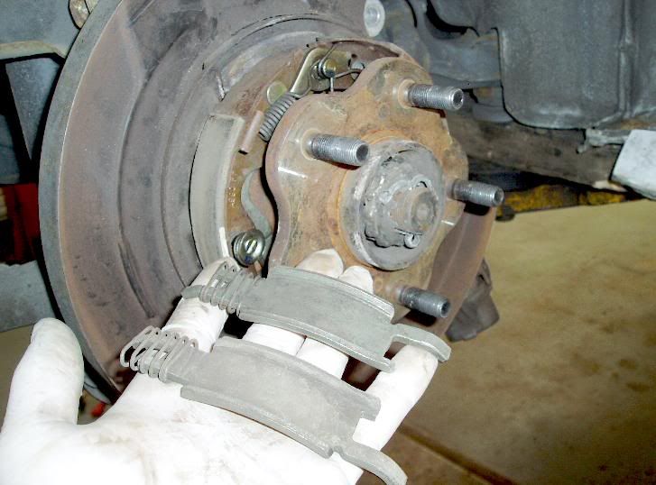

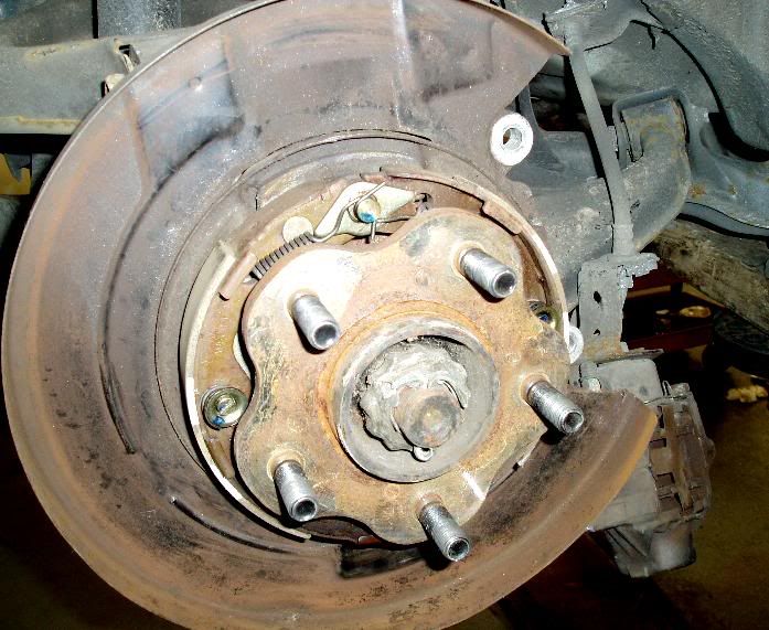

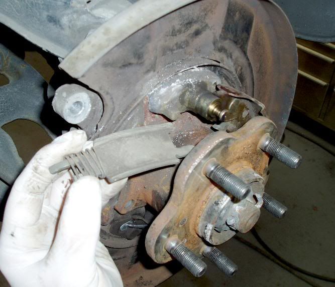

Ok guys who knows whats wrong in the photo`s? will tell the story that goes with it when someone guesses correctly.

Well to my fully trained eye i can see there is no disk and the caliper is hanging off :p
drums... not a zed then?
Doh, matey I know you know that its the rear handbrake on zed lol.
For access of course:D
is there no brake cylinder??
Erm thats correct there isnt...not supposed to have one (lol)
I do now :confused: :headvswal
Oh man you should have edited your reply quick before anyone noticed:D
To be fair its difficult to see especially if you do not know the layout of the handbrake, one of you is close but need to expand the answer, to confirm the shoes are moved by a lever which is pulled by the cable attached to the handbrake lever so no cylinder.
Clue ? handbrake not working, never would in a million years
i assume the two springs pulling against each other wont help
Oohh so close, but the springs are correctly placed, you and danny need to brainstorm.
The shoes will not move with that thing bolted through it?
No, although it looks like a bolt it is actually a slim pin though a large hole, and the shoes pivot on it.
The guide plate is upside down ! (for everyone else - thats the gold triangle piece of metal that the springs are fixed to at the top)

no adjuster/strut?
dan.:)
YYYYYEEEEEEEESSSSSS:nana2::nana2::nana2::nana2:
oh yeh LOL, I did'nt even notice that.
The guide plate was still upside down as well though, but not nearly as important LOL
