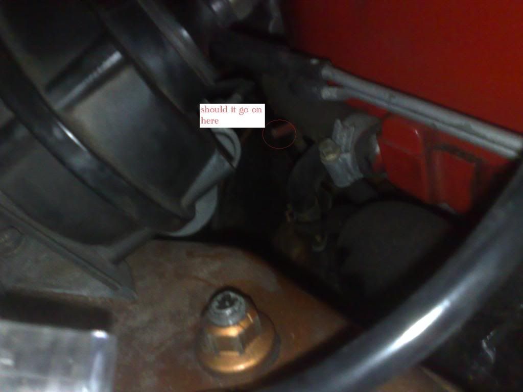

Where should the pipe under the plenum attach to? noticed it wasn't plumbed into anything.
And where should the pipe with the white dot go to? mine has a screw in the hose.
Cant see what pipe we are looking at????? but as anthony said, thos epipes with those dots on them are the aiv pipes, ive goten rid of all that crap.
its the little metal tube, its hard to photograph because the camera focuses on everything else

That pipe looks to me like the pipe that connects the egr solenoid valve to the top of the egr valve.
no idea pete mine has had the egr bypass so maybe like paul said its summit todo with that not 100% sure on this myself tho
