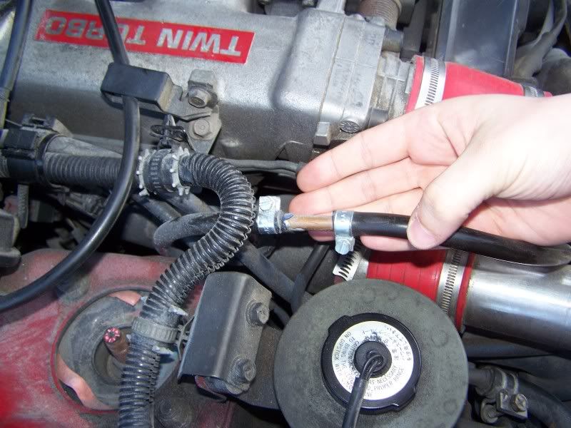

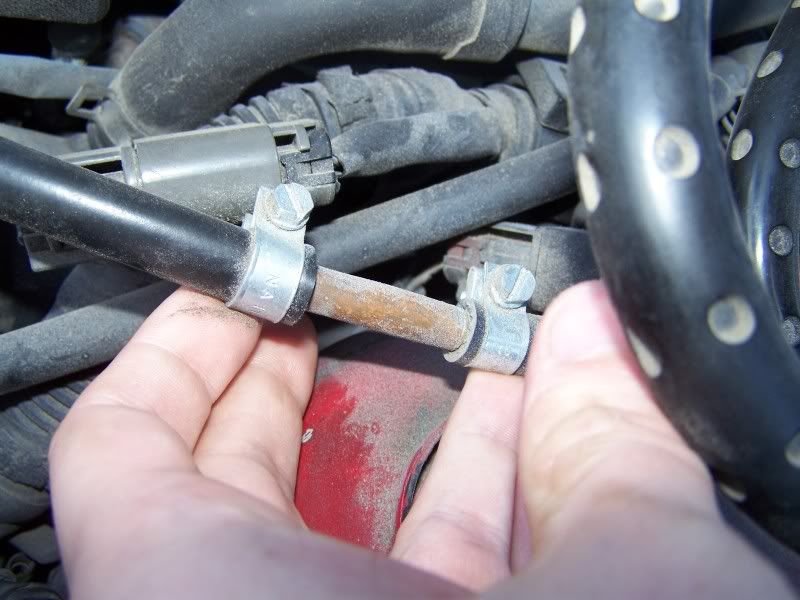

Unfortunately i have no idea. i have no boosty controller (electrical) as far as i have been told so far the two solenoids are rusty and where they were exposed won;t work... although it looks like they were just pulled half out and tightened.. wonder if i can try putting them back in?
all i know is i hear a whistle when i accelerate (which sounds like the hole) but short of someone actually showing me i am lost. having someone look at it later but i will just go and take a photo of the solenoids now.
ok got the photos to what i believe are the solenoids
do you reckon these would still work ? is this the way they are meant to be or are they meant to slot in further?

Hi mate, they're not solonoids, solonoids are in essence an eletro mechanical switch, in this case they'll open to release boost pressure to avoid over boosting (stand to me be corrected as I'm still learning) they are possibly boost jets? Some one will able to say for sure though. As said in a previous thread, get it checked by an expert, they'll be able to tell you what needs to be done to get it running correctly...
