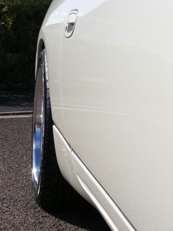

yes it would fit... and dependant on the wheel and tyre.. it would look like this...
pics courtesy of jschrauwen... hope he doesnt mind...
these are 19x10 rears with a +33 offset. as you can see if he didnt have the stretched tyres on it (265/35/19) it would foul the arch, so it really depends on your wheels offset
