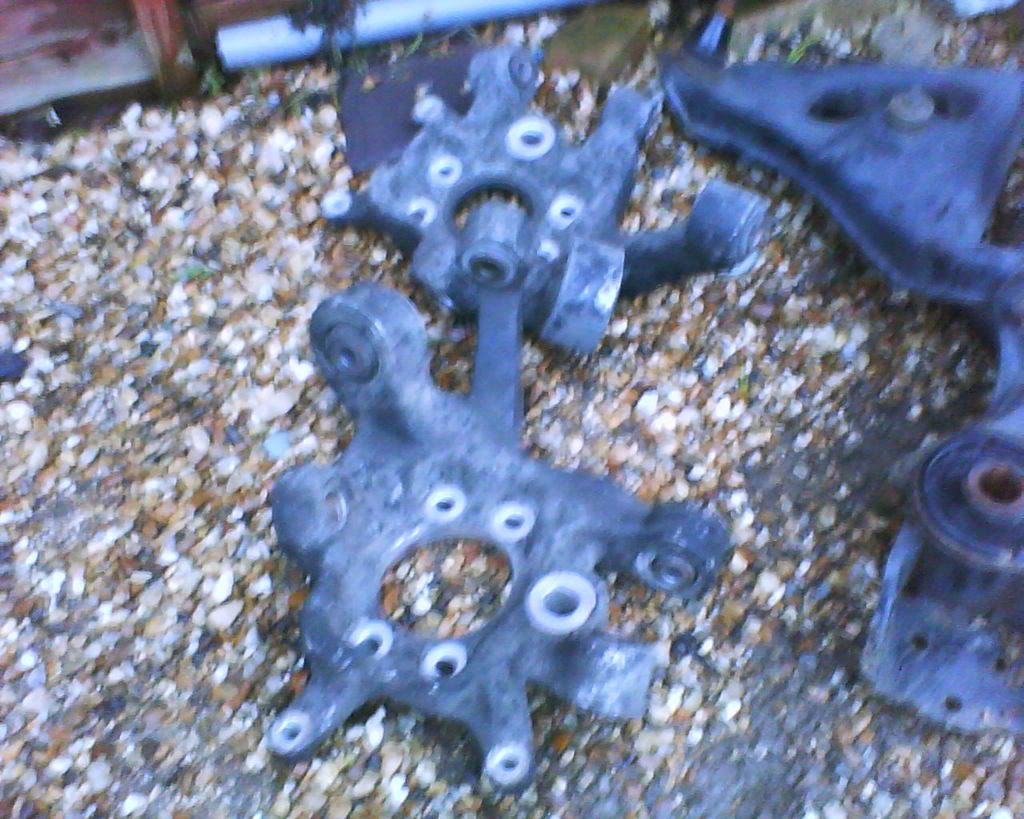

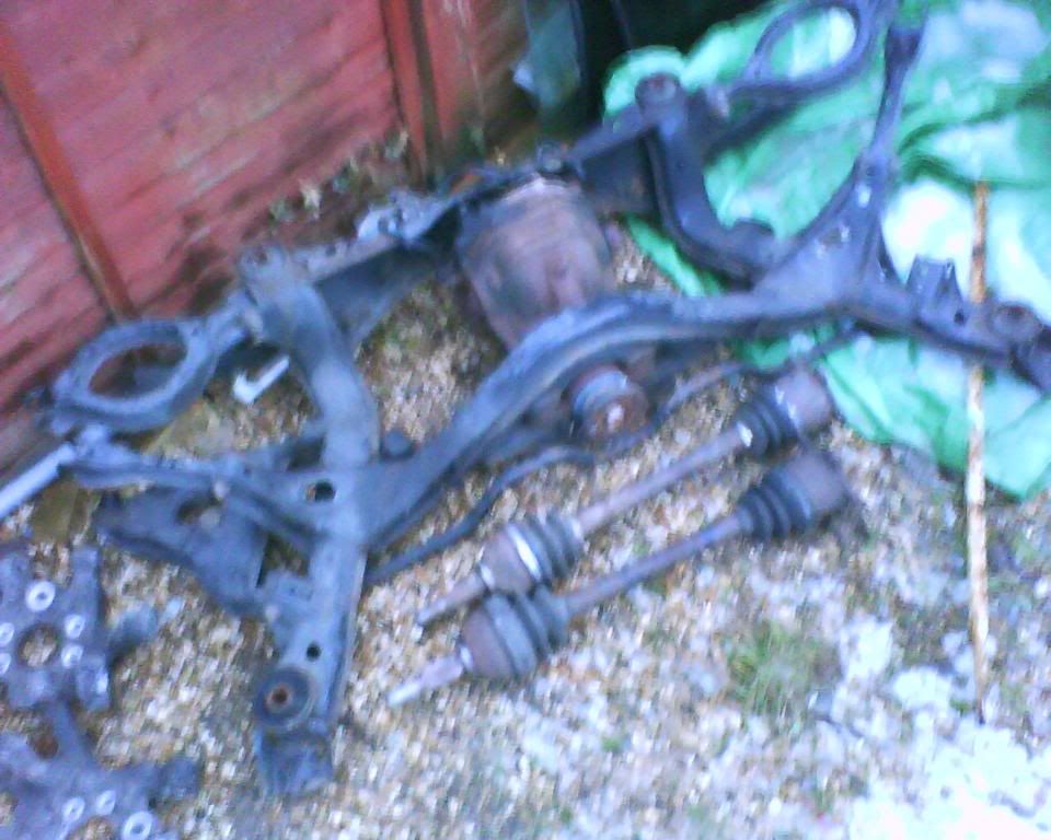

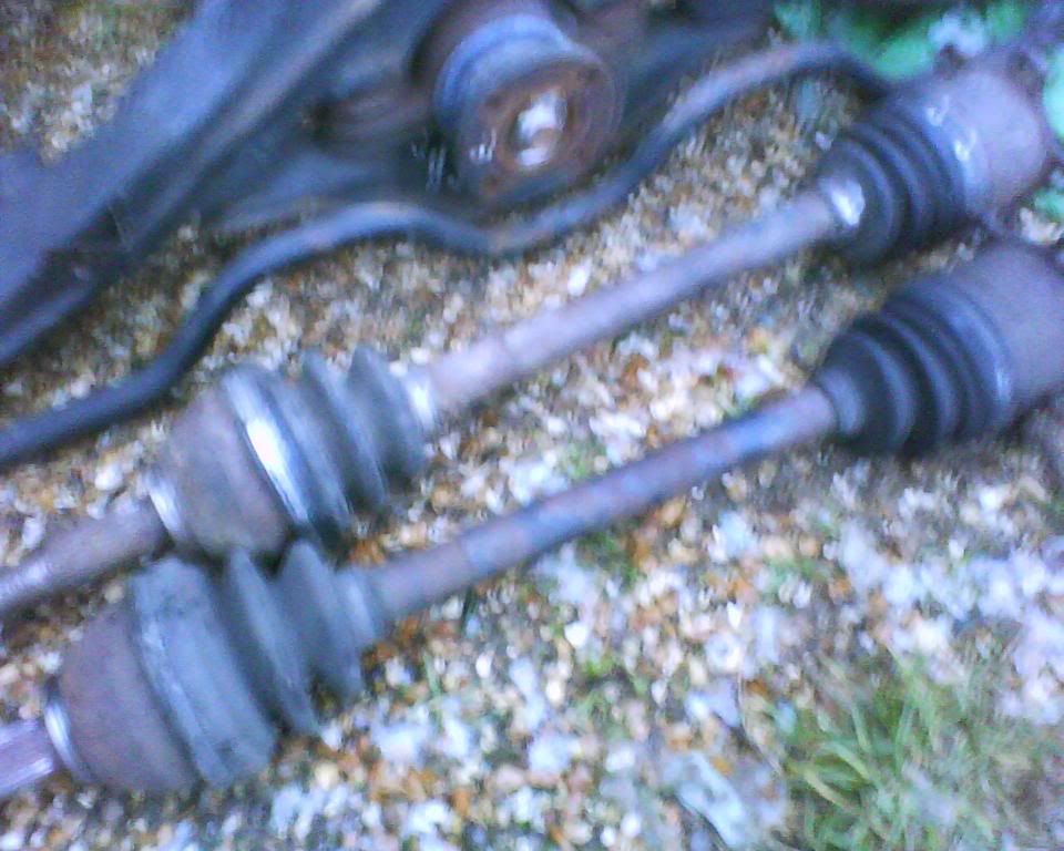

Here's the pics of my subframe and diff:)
Pics are rubbish, but there off my phone
from what i can see, you are missing both diff side flanges (the bits that slot into the diff and bolt onto the half shafts) you're also missing the hubs (which bolt through the knuckles then the half shafts slide into them). you're missing the passanger side lower swing arm aswell.
all of which can be sourced easly.
the side fanges and hubs MUST be from an NA but the swing arm can be off either.
ive got the side flanges and possibly swing arm (pending on condition of ball joint).
speak to Wosser if you're interested to agree a price as they are off his old black NA
