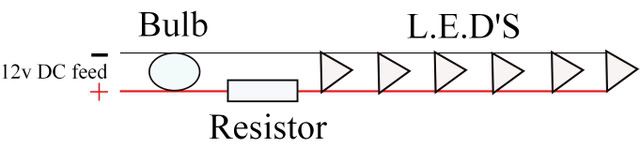

NOTE: If you use a resistor at the feed end before the first LED you could wire the others in parallel and that will do keeping the number of resistors down. Otherwise then you will need to fit a resistor to each LED. If you need here is a basic diagram.

But doesn't this defeat the whole object of fitting LEDs? If a bulb blows you still have to change it. I think putting a low value, high-power resistor across the feed would be the better option.
