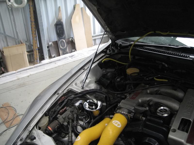

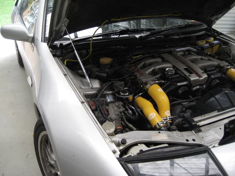

Bonnet strut works well for me
And here is the link to the How To
Tony from Oz
