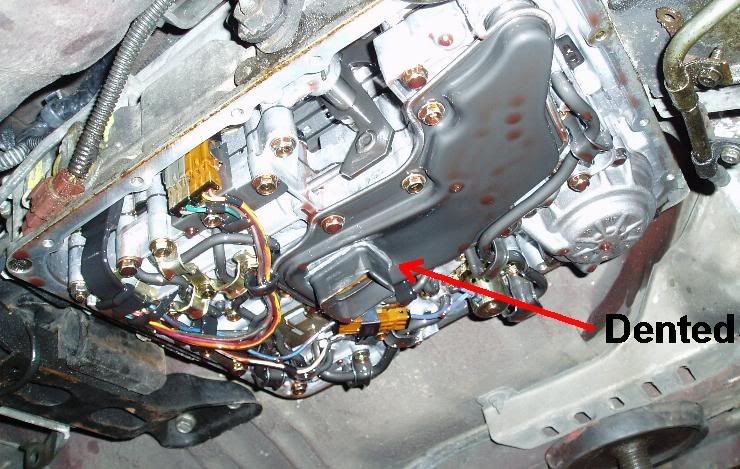

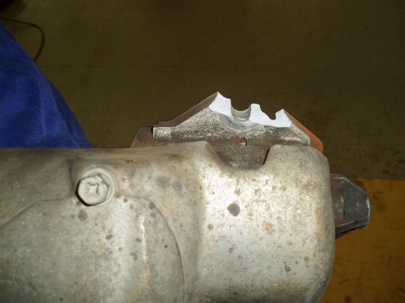

A cautionary note to not jack up your zed on the auto box sump!
Jeff TT
hi
just wondering wot sort of damage that would cause or wot else could go wrong because of that damage
Restricted line pressure, poor drive, left unchecked would damage the pump.

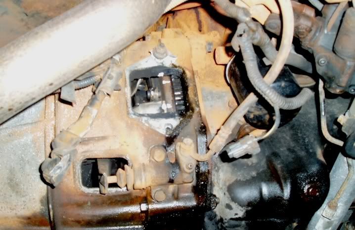

Jeff TT
Not uncommon, but the result of missing lower bolt on starter moter.
Jeff TT
I know these ones.
1) Jacking up the car under the autobox
2) Missing lower bolt from starter motor.
YAY 2 points for me. Oh... are we not playing that game any more ?

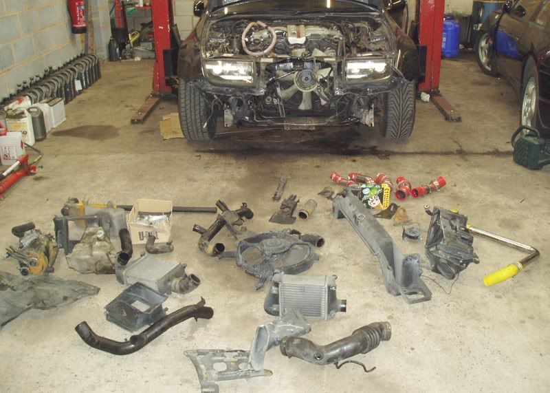

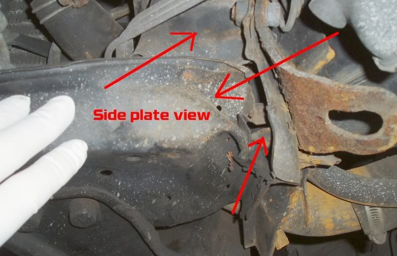

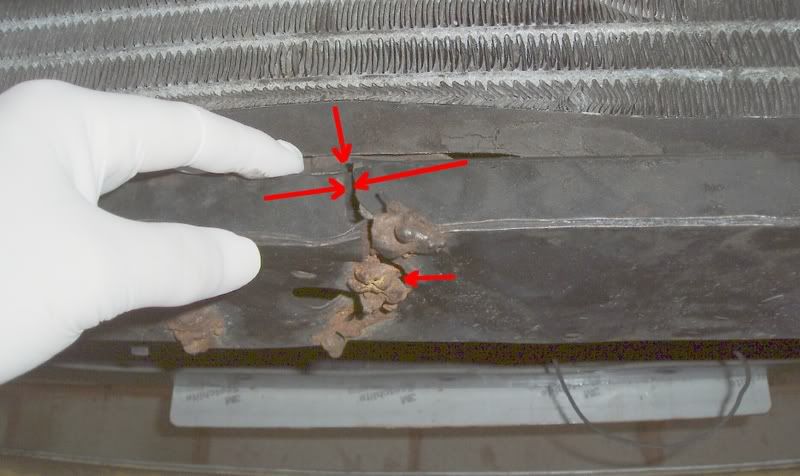

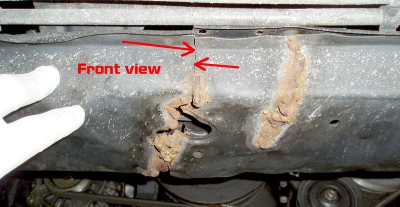

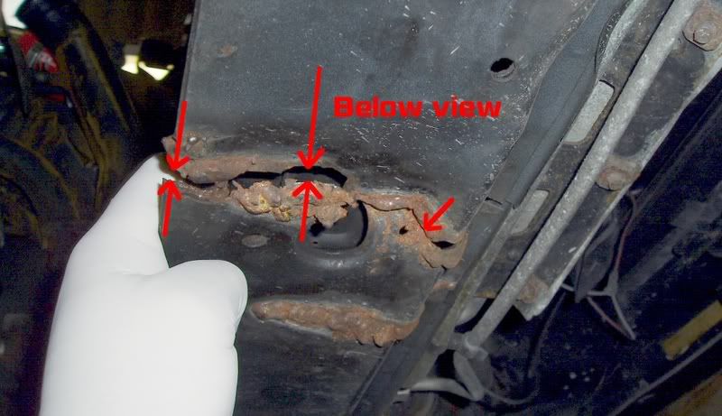

Not everyone can weld!!! shocking attempt at repairing a front member under the radiator, this after all is where the tension rod bushes bolt onto.
The amount of bit needed to be removed to replace the panel

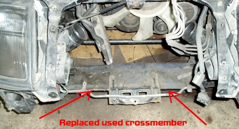

Replacement used panel
