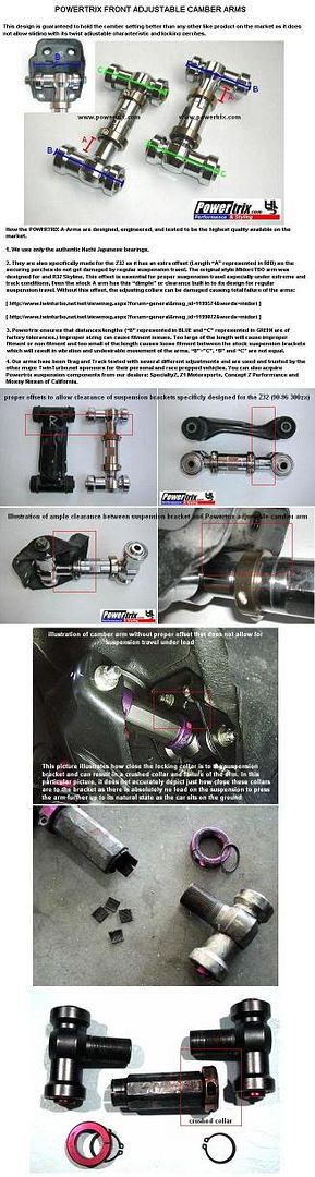

be careful with the front upper camber arms... r32 ones aren't the same as 300zx ones - there's some pictures on here somewhere of the difference... and the resulting failures!!
Really?
They are listed as being Z32/R32 fit, can you give me any more info?
mentioned in here http://300zx.co.uk/forums/showthread.php?t=75334&highlight=driftworks+camber but I can't follow the link!
It's to do with the shoulder being a different length, which causes it to foul when the suspension moves full travel... I can;t find the pictures at the minute, but there was one with the 2 shown together, highlighting the different proportions.
Yeah unfortunately that link don't work now cos Danny deleated the actual post.
Anyway pic below, sorry just yet i can't make the wording bigger to veiw.
But in short, Nissan of the late 80's early 90's used very similar suspension set ups, however similar being the operative word, offsetts are not the same across the board. So in theory parts made for other Nissan's will certainly fit in the space given, but doesn't always mean it does the same job.
Add to that our car is possibly the heaviest out of the other nissans our parts will fit and vice versa, i personally favour these type of parts to be supplied and manufactured by companies who specialise in the Zed only and not generic Nissan.

Hi Pete,
Ref. missing link: that was removed in the cleanup when the Smithy's Place section in the Traders Forum closed. Sorry about that.
However, it is EXACTLY as Smithy says - the R32/S13/S14 listed upper arms ARE DIFFERENT to the Z32 upper arms. I would STRONGLY recommend you DO NOT buy the driftworks upper arms (or tension rods for that matter). Stick with parts that you know have been designed SPECIFICALLY for use on the Z32 ie, Powertrix parts as per my previous post.
